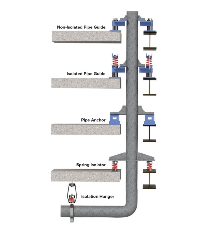

Hello I am a PE with 6 years of experience mainly focusing on mechanical pipe supports for skyscrapers in NYC.
We have two senior engineers at my company who have differing views on the need for bracing on top of the building. Think 1000' tall skyscraper.
I am struggling to find in the codes if I have to design lateral or seismic bracing for the piping towards the top of these buildings.
I have read MSS-SP 58, MSS-SP 127, and the NYC building codes.
As far as I can tell based on MSS-SP 127 any pipe subject to wind load needs some type of bracing. In general we put seismic supports on piping involved in life safety but for HW,PCW, CHW piping we do not include any type of bracing.
Just curious if anyone can point me to a specific code that covers building sway for mechanical pipe supports.

The pipe needs to sway with the building. Bracing it may turn the pipe-brace structure into a rigid truss with less flexibility than the building.
Lots of ways to skin that cat. Can you show us what your proposed brace scheme looks like?
