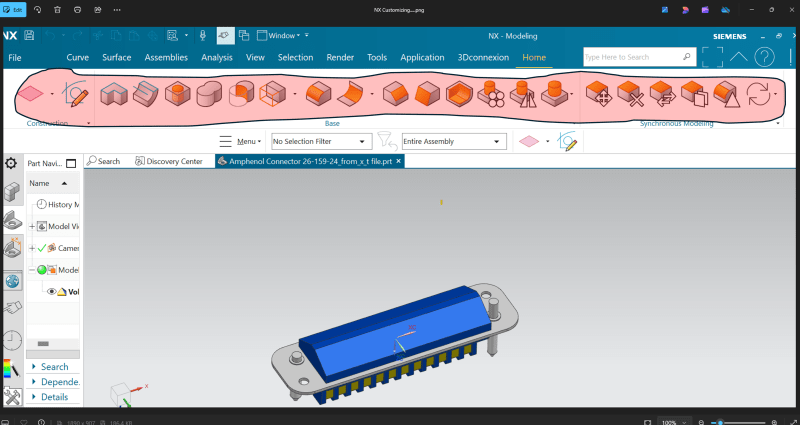

I moved back to NX after more than 10 years of using other CAD systems.
How could I add name to feature labels (shown in the picture)?

The tools in the picture do not have their name.
How could I add the name until I will become (again) familiar with them?......

If you hover the Cursor over the Icons, doesn't the Name appear?

Yes, it does.
I am satisfied with your prompt reply.
Thanks a lot, Mr. Baker and please excuse my ignorance!

You are currently in "touch mode", you can toggle off the pointing finger icon in the title bar to turn it off. This may or may not bring back the icon labels. If it does not, you can go into customize, right click on a button icon and choose "show label".
