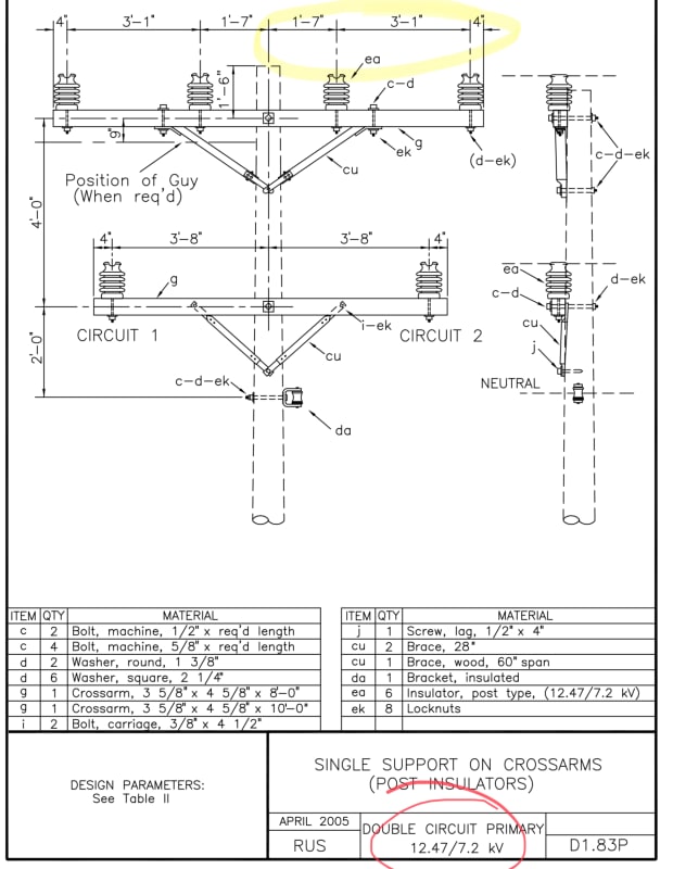

Does anybody has a typical pole design dimensions for 13.8 kV similar to the one show below?
Interesting that those dimensions add up to 10ft exactly, so it looks more like that is the max separation available from a 10 foot long plank(!)
The one below it is max separation for an 8ft plank
So not sure if these were actually "calculated"
How exact can you get on a wood plank?
That said, you only need an eight foot cross arm for three phases. The thing is the two outside insulators are on the ends. The middle phase can be on either side of the pole, usually with the pole ground on the other side of the pole.
It is likely easer to put the Middle phase on one side an keep it there, but I have heard it said it is better to change side on each pole.
Off the top of my head, I am thinking the spacing is about 18 inches from center to center for the conductors on the side with two phases.
The only change needed to the drawing is to change the voltage in the title block.
I agree with jghrist - those dimensions look fine for 13.8 kV (see NESC Section 235 for reference). However, the military overhead line construction specification has pretty good pole details similar to the detail you posted. See here, and look under Related Materials for "Pole Details."
