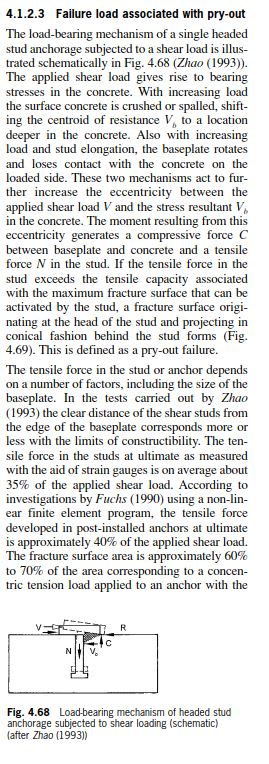

I agree that stirrups and ties could likely resolve a pryout failure, however in the thread I linked, KootK's post showed a failure mode where the anchor bears against concrete and almost looks more similar to a tension failure, in that the breakout cone comes up to concrete surface. I'm not sure how I'd determine what tensile force would need to be resisted when just a shear load is applied, and the failure looks close to the surface - would I even have a stirrup yet if my top cover is 2"? I'm not sure if the failure seen in figure c) and d) is only seen when anchors are shallow since the crack appears to propagate from the embedded stud head.
I'm worried about a high stress concentration on the concrete near the top of the anchor just under the baseplate due to such a high shear.

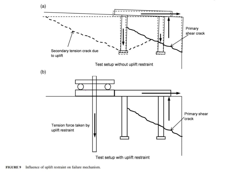

More recently there was a paper by Eligehausen et al studying supplementary reinforcement design for anchorages. In the experiments, to preclude pryout failure they had an assembly which prevented rotation of the baseplate and used extra fixings to resolve the tensile force. I'll dig it out tomorrow at work, might be useful for you. Another guide on detailing would be ACI section R25.4.4.2 - its for headed reinforcing bars anchoring into walls or columns however it shows a good strut and tie analogy and how the local phenomena is reinforced against to then resolve via strut and tie into global bending/shear of the concrete element.

The paper I was referring to is "A new model for concrete edge failure of multiple row anchorages with supplementary reinforcement—Reinforcement failure" by Sharma et al (it is a fib Technical Paper,
They use an uplift restraint to preclude failure due to rotation of the baseplate inducing additional tension.

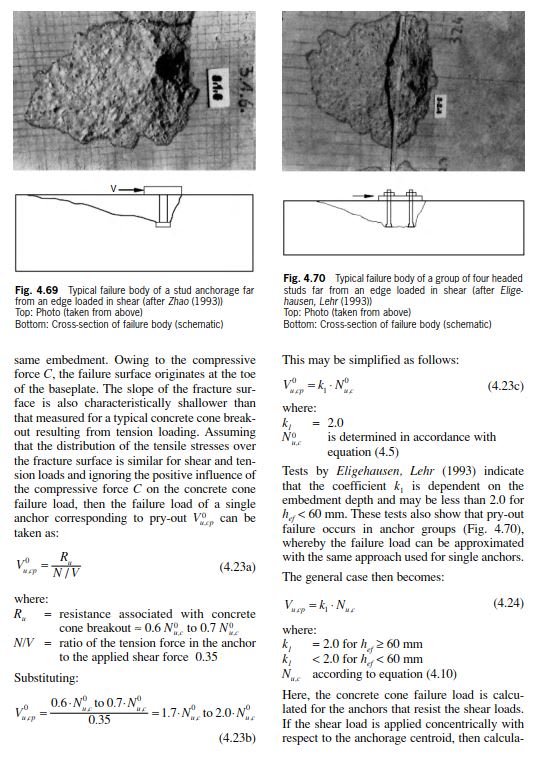

My baseplate is 12" x 27.5" sitting on a pileaster with an ideal max embedment of 22". From my understanding on the figures you put above and prior responses, if I took 40% of the anchor shear and applied it as a tensile force it would be roughly equivalent to the pryout force. I'd then have to follow the breakout cone up on a 35° angle and develop the bar above and below this intersection with the reinforcing I provide.

I've attached the derivation of the pryout capacity equation where it talks about how the typical pryout capacity is obtained including the 40% tension and 60-70% cone size etc, which is what my answer above was based on. Based on a semi tension cone failure surface (note this might also indicate that reo in a certain zone may be less effective) being what forms in pryout failure, I'd say that reinforcement similar to supplementary reinforcement that you'd detail for tension cone failure would be the way to go, although as mentioned theres no code or guide anywhere that I know of that tells you how to do this. Probably worth having reinforcement in all directions in your concrete to help with confinement.
