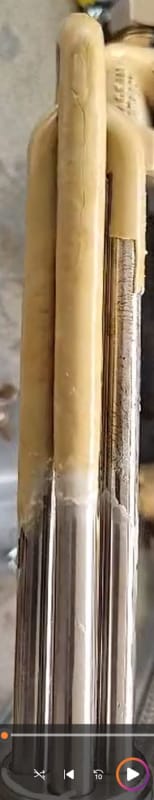

Normally a coil heating element is used like this:
does anyone know the typical energy density (W / cm2) of the heating element?

It varies depending on the rated flow rate, temperature rise and design. The energy density / heat flux is simply the rated KW divided by the surface area. Are you inquiring about information concerning the one in the pictures? If so, the electrical diagram, specifications, flow diagram would be helpful along with the exact information you are seeking to determine.

at that density they will be destroyed with limestone very quickly
this is our current heating element which is 27W/cm2 (3600W/135cm2=27W/cm2) - this is after 6 weeks in a hard water area!

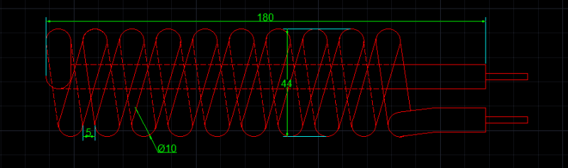

with this design we get to 8w/cm2 ( 3.14*10*1360mm = 427.04cm². 3.5 kW / 427 = 8.19)

the one in my picture is from our version of an instant water heater - so water flowing past the heating element

I need to know what energy density to target when I redesigned my heating element for our instant electric shower. Heating element is 3.5 kW, approximately 20 cm in length.
