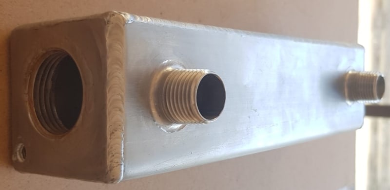

Hello,
in the UK, Ireland and several other EU countries, instant electric showers that heat cold water at the point of use are common.
in the shower unit is a heating element that is between 7 to 10.5 kW (230v 30-45 amps)
Normally a coil heating element is used like this:
does anyone know the typical energy density (W / cm2) of the heating element?
thank-you

our current heating element which is 27W/cm2 (3600W/135cm2=27W/cm2
The picture looks like two heating elements. Are they in series or parallel? Are the numbers you provide for one or both?
this design we get to 8w/cm2 ( 3.14*10*1360mm = 427.04cm². 3.5 kW / 427 = 8.19)
Same question, are there going to be two of these or are you trying to do the work of the two in the first picture using just one element?
they are in parallel. Total surface area across both elements where heat is emitted is 135 cm2 with total power output of 3600W
This will most likely be a single coil with a surface area of 427 cm2 and a power output of 3500W

The current design example photo looks like the result of a positive feedback loop. The energy output along the length of the heater is a constant, but to accomplish that as the water entering at one end heats, the temperature increases to emit energy that energy along the heater. The hotter the water gets the hotter the heating element gets.
In the current design example photo does the water enter along the centerline?
As the temp increases in the flow direction the power into the heater needs to decrease at each incremental location in order to limit the temperature gain.
3DDave said:
In the original example photo does the water enter along the centerline?
the 1" threaded hole on the side is where the heating element attaches
the inlet is to the left and the outlet is to the right
This is a teardown of a shower unit -
Note that the two heating elements are separately operated and provide different amounts of power, with the lower power element closer to the outlet. Also note that the water inlet is not axial and there is a counter-flow aspect to the outlet tube to help average the heat transfer.
Ok - then depending on how the element is installed the current design elements could have their flow restricted against the walls of the housing causing that taper to the lime buildup.

Because the water remained colder to the inside it delayed limescale formation; where it was impeded on the outside the limescale formed closer to the inlet.
Picture if the heating element was tight against the wall; very little flow would happen and the water would be much hotter than if it was in free-flowing conditions. Of course the hotter the water, the less heat transfer from the element, which means the element gets hotter yet, spiralling up to a higher temperature. The temperature gradient results in a lime scale deposition gradient.

i do not think its that simple, because the design of the heating chamber will affect the flow rate m/s of water over the heating element which will massively effect the heat transfer and therefore the peak temp on the heating element
i did not consider that the water is actually moving very slowly in the heating chamber because it goes from a circular pipe with a cross sectional area of 78,54 mm2 to a Cuboid with a cross sectional area 2916 mm2 (less the cross section of the heating element).
the speed of water in the heating chamber will be very low.
i will need to both increase the surface area of the heating element and decrease the area of the heating chamber - but i need to be careful that i do not add new problems by doing so
