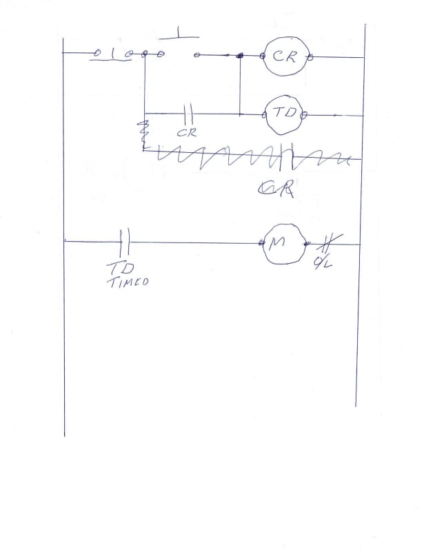

My understanding is this circuit causes delay of motor off by 1 second. I do not understand why the CR required and why the timer relay alone cannot be usedbe combined here?
1
OP,
I don't think the circuit as shown provides a delay of motor off. It provides a delay of CR deenergize. Once the stop button breaks, the M contact will fall out and there is no path for power back to the stop switch. No delay, just stop. The CR will remain energized for 1 second after until the TDR drops out.
That is one confused circuit.
The control relay is used because there are no instantaneous contacts on the timer relay.
Try this basic circuit.
Please forgive my silly mistakes.
Thank you for pointing out my mistake,Mr Che.
CORRECTED CIRCUIT
However, if you use a Timer Relay with instantaneous contacts as well as timed contacts you may use this circuit without a control relay.
CORRECTED CIRCUIT

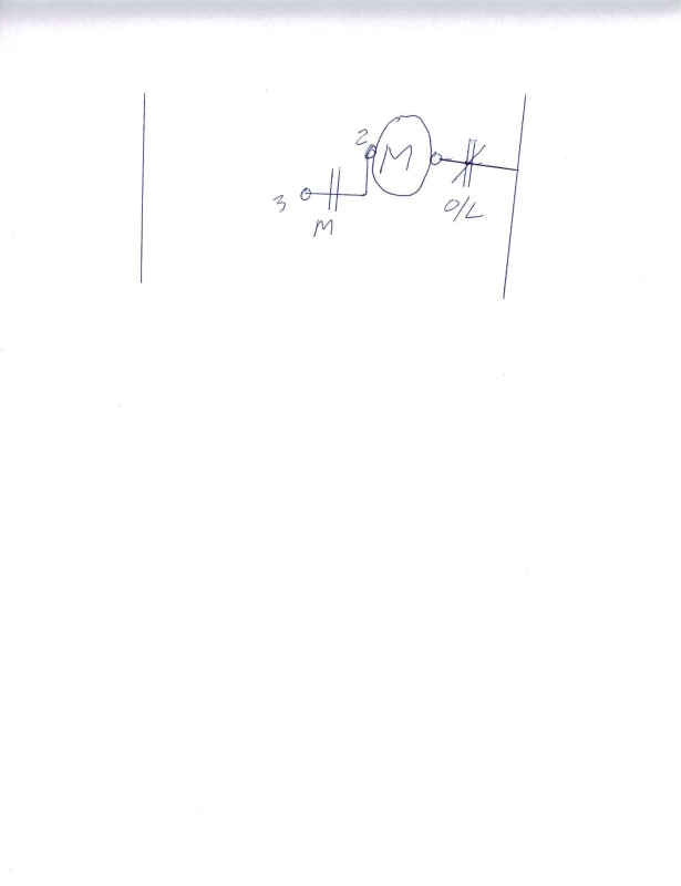

1. Both proposed Circuit 1 and Circuit 2 are incorrect.
2. a) Circuit 1 , CR N.O. contact should be wired to TD coil terminal a. Its function is to "seal-in", maintaining CR and TR are energized when the Start N.O. contact pressure is removed. To Stop, press Stop N.C. push-button.
b) Circuit 2, TD inst. N.O. contact should be wired to the TD coil terminal a.
Its function is to "seal-in" as above a).
c) In both circuit 1 and 2, the O/L N.C. contact placed between M coil terminal b and the grounded line is a violation of NEC/CSA. Reason: In case the M coil terminal b is grounded, the system remains running until the motor is burned out; even the O/L N.C. opens.
d)In both circuit 1 and 2, the symbol for TD timed and TD delay are incorrect.
e) The original circuit shows one line is fused, the other line MUST be grounded per NEC.

If I were in your situation, I would print off copies of this circuit, get out a pack of highlighters and go through each logic step and state, it should become clear to you then and you will have the "backup" if anyone proposes something different.
State 1: Start pb is depressed: M energizes - then CR energized - then TDR energizes
State 2: Start pb is released: power continue to flows from terminal: 1 - 5 - 1A - to keep M energized, 1 - 5 - 6 - to keep TDR energized, 1 - 5 - 7 - 8 to keep CR energized
State 3: Stop pb is depressed t<1 : M deenergizes - power flows 1 - 5 - 7 - 8 CR remains energized - TDR deenergizes but remains unchanged - - TDR times out - CR deenergizes.
State 4: Stop pb is released t<1 : M remains deenergized - power flows 1 - 5 - 7 - 8 CR remains energized - TDR remains deenergized but remains unchanged - TDR times out - CR deenergizes
State 5: TDR changes state after 1 sec : CR deenergizes.
State 6: Stop pb is depressed for t>1 : M deenergizes - power flows 1 - 5 - 7 - 8 CR remains energized - TDR deenergizes but remains unchanged - TDR times out - CR deenergizes
This is already implemented at the site for various 480/600vac motors, it is not a concept
Shown here is typical factory pre-wiring of a typical magnetic motor starter in North America.
This is an approved assembly, and the NEC rules for field wiring do not apply.
Regarding your concern;
"Reason: In case the M coil terminal b is grounded, the system remains running until the motor is burned out; even the O/L N.C. opens."
The wire connecting the M coil to the O/L N.C. is a short jumper between the coil and the overload relay, both of which are mounted on the same base plate.
There are exceptions, but they are special orders for very rare special applications.
[Anecdote Alert] Yes, I have encountered special applications where the factory wiring of the O/L circuit was altered.
I specially remember it as the alterations included mistakes in the circuit that required the field rewiring of over 20 MCC buckets in the field.
The unintended consequence of the change was the self destruction of contactors under unanticipated operating conditions.[/AA]
I repeat, that the wiring of the overload relay is part of an approved assembly and therefore is not an NEC violation.
Well over 99.99% of magnetic motor starters supplied and installed in North America are pre-wired this way.
