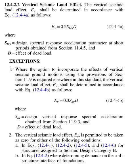

When you do seismic analysis, there is both horizontal and vertical seismic forces you have to consider. Ev is vertical, Eh is horizontal. So assuming you aren't using your columns as any part of moment frame to resist lateral, you would have to at the very least resist the vertical seismic forces and include them in your load combinations that you have shown above. This vertical component is defined in ASCE 7.
Yes, columns are not the part of lateral load resisting system. So do you mean only the vertical component of seismic component should be considered for the design?
The vertical component of the seismic at a minimum, plus you must design the columns taking into account the potential lateral seismic drift, therefore increasing the second order effects on your columns.
