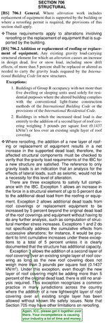

My understanding based on previous editions of the IEBC is that the 5% increase was based on the total gravity load. The wording in the more current versions, however, could be read as 5% of the load type, i.e. dead, live, or snow.
“Any existing gravity load-carrying structural element for which an alteration causes an increase in design dead, live or snow load, including snow drift effects, of more than 5 percent shall be replaced or altered…”
How do you guys read this?

Say the dead load was 100plf, and the snow load was 50plf. Originally, you had 150plf. Now, you have 1.05*100plf+1.05*50plf=157.5plf. 157.5plf/150plf = 1.05. The total load went up by 5%. Not 10%. Mike isn't writing the load combination, he's writing the algebraic expression comparing the new load to the original load to determine the percentage increase.
The more I look at this, the more I think the new wording makes a little more sense. Before, it was a question of a 5% stress increase. To prove that, you not only have to determine the loading before and after, but you have to analyze it, too. So a real stickler of a reviewer could demand to see calculations proving that the stress increase was only 4.2% (or whatever). Now, it's a simple loading comparison. Dead load was 100plf, now it's 102plf...good to go. It actually makes it a lot easier to comply with it. Unless, of course, you're in an area where effective snow load has gone crazy. But, then, you'd probably have to do it anyway because the stress will have changed.
As a side note, it looks like the actual text hasn't changed between 2018 and 2024. Here's the 2024 for reference, I notice the bit about current IBC in there now, I was working off brute recall.
Source: 2018-2024 IEBC

But none of this really matters, because the "new" language (that's been around since 2018) is about individual loads. If any of the individual loads increases by more than 5%, you have to prove what's there is sufficient or reinforce it, as opposed to 2015 and earlier where the threshold was a 5% increase in stress. Like I said in my last post, I think I like the new way better. It's a much faster go/no go check.
And I'm not sure what all the concern about the "new code" is. That's been the case since the first IEBC was written in 2003. If you exceed the 5% stress threshold, you have to meet the IBC.
