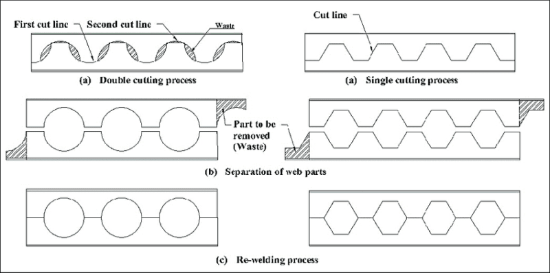

I've seen this claim before and it's always struck me odd (2nd link above)
"Better strength and stability – their crenellated design makes castellated beams more resistant to bending and deformation."
I feel it should include the words "for the weight of the material that is used."
I recall seeing it as a way to take an I-beam from the rolling mill and convert it to a deeper beam using a trapezoidal zig-zag that is shifted and then welded along the middle at the tops of the trapezoids. It left them with hexagonal openings.
The bit with circular holes is wasting material that is cutout and discarded, but they have an interesting look and reduce installed weight, so why not?

It's along the neutral axis so it has to resist the shear between the upper and lower portions.
I only did direct mechanical design, not regulated and codified structural design, so I'd ensure there was sufficient shear area and then divvy it up some interesting way. Same thing happens to main spars in aircraft wings - lots of holes. I would not be surprised if the standards have more to say on the subject.

Increases the depth of the beam also. Blodgett has good chapter on them.

They should be stiffer than the source beam, if one ignores the holes.

Do they ever just cut a bunch of circles, as they do with regular beam penetrations? Or is it always cut and rewelded for material saving?
The parking isn't a garage per se it's a single level on the roof.
Edison, it's not typically done that way, they cut the beam mid depth then weld it back together to make a deeper beam with the holes in the new midline. See the figure above.
Now, that photograph above, I'm not convinced that's a standard castellated beam. that looks like what you describe, straight up cut out holes.
3ddave, I think the comment is accurate, within the context of creating a larger moment of inertia (potentially larger strength as the flanges are farther from the centroid, provided shear in the web doesn't govern), and increasing the effective stiffness for the same weight (deflection)
