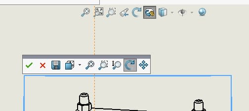

Are you trying to rotate a part model (*.sldprt) or a view on drawing document (*.slddrw)?
Best regards,
Alex
Alex,
I want to rotate either a part model and an assembly.
Thanks for your time!
CAD 2015
Also, if you select the view you can rotate the model. Just another option.
Chris, CSWP
SolidWorks
ctophers home
YES Chris, thanks a lot!..............[2thumbsup]
CAD 2015
Hi, CAD2015:
Doesn't middle button on your mouse work for you? Do you want to rotate models precisely? If not, you can just click the middle button and move your mouse.
Best regards,
Alex
Alex,
Using the middle button for view rotation is alright, but not for defined rotations moves.
Chris suggested a very good option.
