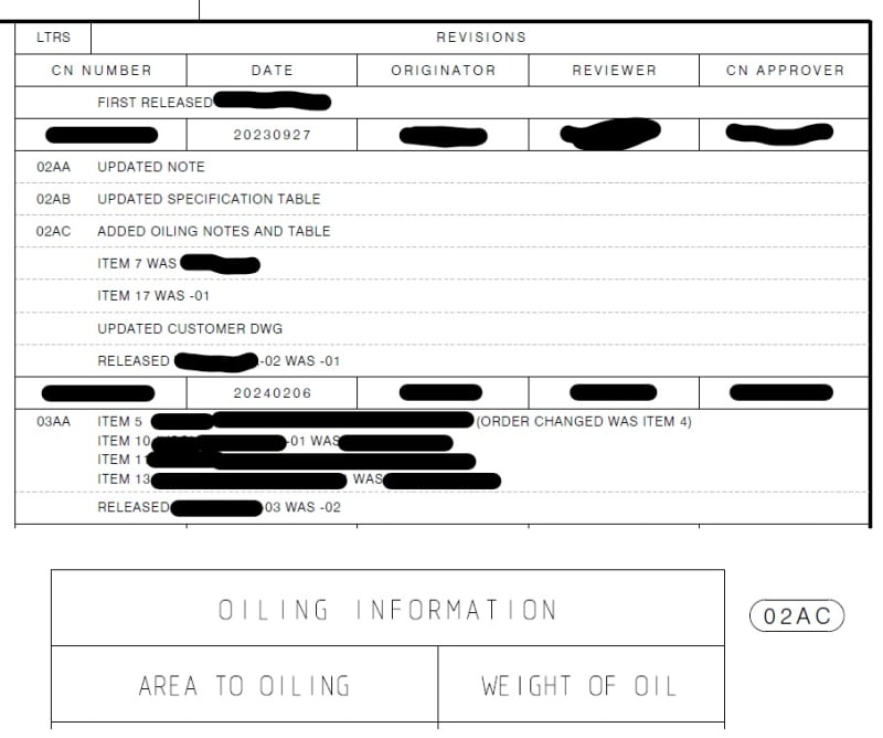

What is the industry standard, or standard on recording of what changed on a 2D drawing? For example, if we modify our print, we record every dimension and or note that gets changed on the print. This results in the tedious task of going in and ensuring you get everything recorded correctly.

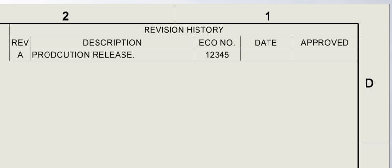

Create some type of ECO form: the form indicates what has changed. indicates revisions, disposition of change, reason of change, etc.
The drawing has a revision table that tracks revision changes. It can reference the ECO number.

We have an ECO form, and ECN process. The revision table do you have an example of what that looks like? I have attached an example of what we usually do on the right hand of our prints. I agree it is important to track and document changes. Just wondering if there was a better way than what we have been doing for years and years. Thanks for the feedback.

I see no reason why to clutter a dwg with detailed changes. List them on the ECO form. Ref the ECO number on the rev table.

Thanks for sharing this image do appreciate it.
SDETERS,
This is how we do ours, we track all the changes with drawing markups & an ECR form, currently.
But as you can see we have changed that over the years.
At first there was only a change to the title block revision level, then we change to only a number, then we changed to a year based numbering system within our QMS.

I have had it done different ways at different companies. Currently we just list the ECR in the revision block like this: REVISED PER ECR #####-##.
We have a few canned text lines that we use in the revision block.
Other companies have listed every change with a number for each change, like: C1 WAS 23.2; C2 WAS 12.4.
in both cases, we do use a revision triangle placed next to everything that changed in that revision. We only carry the current revision triangles to keep the clutter down.

@ctopher Yes we have Siemens NX with Teamcenter, Our ECN process is HCL notes, so we have two different systems. We are a small company with limited Teamcenter licenses.
We usually have everything spelled out as Looslib mentioned with every change.
The reason I am asking is because there are many different tools (Teamcenter visualization, NX track drawing changes for example) that when these tools are used the tools, will show the difference between the two drawings.

If I have a fabrication drawing, I want to tell the fabricator explicitly what changes I made. I do not want to release the ECR, as it may contain proprietary information. If you change half the dimensions and notes on a fabrication drawing, it really is time to create a new drawing.
