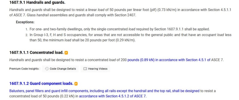

Code calls for a guard at a free edge (or something similar) and that's where the 50 plf, 200 pound point load (I don't think it's 250 pounds as you state), and the 4" sphere passage shows up. (21: sphere passage for a roof). The 4" thing applies to open risers on stairs, but the other items, I'm not absolutely certain.

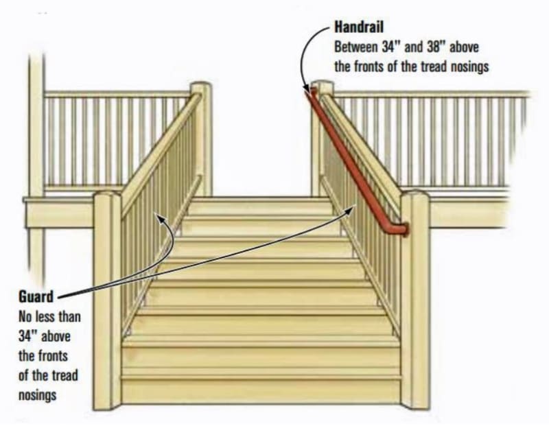

Guards, Handrails, and the IRC, Matthewson, Journal of Light Construction, Oct 9, 2021.
lex - handrail and guardrail are technically two different things, but stairs are required to have both. In some circumstances, they can be the same thing doing double duty. In other cases, the guard rail goes up to the required height and the handrail is attached at a lower level for accessibility and comfort (short people apparently have trouble using a 42" guard as a handrail).
Yeah that kind of matches what that article said, I thought maybe a stair was a different situation.

Guardrails vs. Handrails, Matthewson, Journal of Light Construction, July 11, 2019.

[li]If this is per IRC (residential), I think the concentrated force should be 200 lbs, not 250[/li]

I don't know where the 250 is coming from, unless that's 50 plf x the span of the top rail @ 5'? The 42" does suggest this is IBC versus IRC.

250# is the ADA grab rail force. The IBC specifically allows 200 for stair handrails. So you have the 200# to design for even when there is no "fall" per se.

Is this in the newest version of IRC? Where I work, we're always well behind with the codes, and in the 2018 version, it still requires a 200 lb "Guards and handrails" load "applied in any direction at any point along the top."

As to the 250 lb. I don't know that one. For residential, the 50 plf doesn't apply. That's not doing anybody a whole lot of favor, because the 200 pound point load is pretty rigorous already.
2021 International Building Code.
