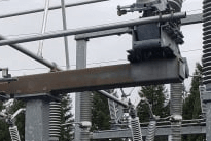

At one substation we've noticed that on multiple two-legged three-phase stands for the 115kV equipment there is the appearance of corrosion between B- and C-phases. Nothing apparent between A- and B-phases.
As can be seen, it isn't just one support structure, and it has a hard edge at B-phase. Interestingly it is just the space between B-phase and C-phase. It doesn't seem to build up across the mounts, it just starts on the C side of B and on the B side of C.
Bad galvanizing seems a bit of a stretch given how it's the same on both supports visible and that it has such sharp edges.
The possibility of only the leg nearer to C-phase being grounded (can't tell in the photos, hasn't been field verified) contributing has been raised. Can't totally refute that, but if so, wouldn't there be at least some corrosion between A- and B-phases? And wouldn't there also be some corrosion between the cross arm and the ground connection?
Thoughts, opinions, questions welcome. Questions that require field observation to answer may take a few days.

The hard vertical lines seem to correspond to overhanging switch mounting brackets. The switch mounting plates might provide protection from rain. It seems like the dark coloration continues for a bit on the left side of the middle phase.

A screenshot enlargement does not help much with the detail needed to diagnose, results are too coarse. This does look more like environmental or iron oxide stain than rust. If corrosion is present it will appear on the flat top surface first.
If there is a way to take some zoomed in pictures of the top surface you will get better answers.
An examination using binoculars may also be helpful.

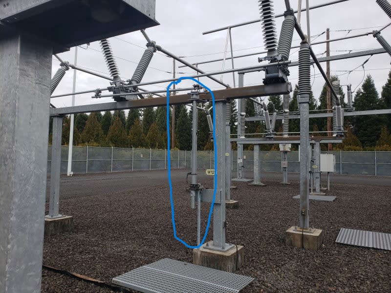

This strange pole thing. Its the only thing that immediately seems different between the two halves of the support.
This is the switch operating rod. It rotates to operate the switch.
The face of the tube seen in the photo is the south face, so I don't think that shading would be an issue.

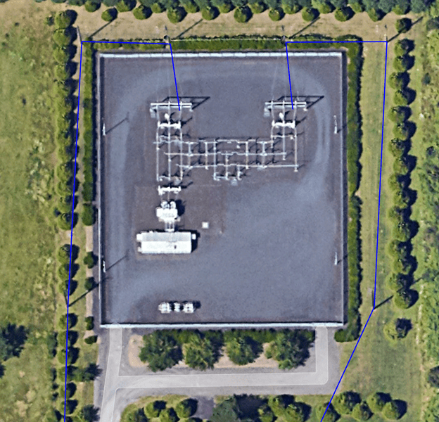

The substation from Google Earth. This is a transfer station between taps from two different lines so the only current on the 115kV is what's feeding the transformer at this location. The photo posted above is from the west bay, the east bay has similar discoloration.

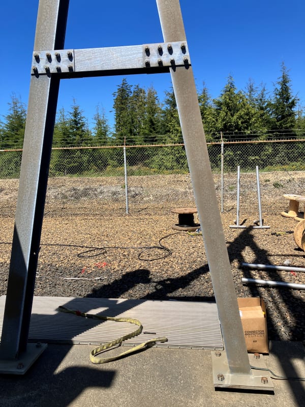

Here's a photo I took yesterday. Less industrial acid rain here, more ocean salt. It's definitely directional, this is the windward side. Lee side is just dull grey. I was interested to see that the less visible leg has a galvanizing defect where the zinc is peeling away. Even with the defect, the steel is still full thickness due to the cathodic protection from the intact galvanizing nearby.
