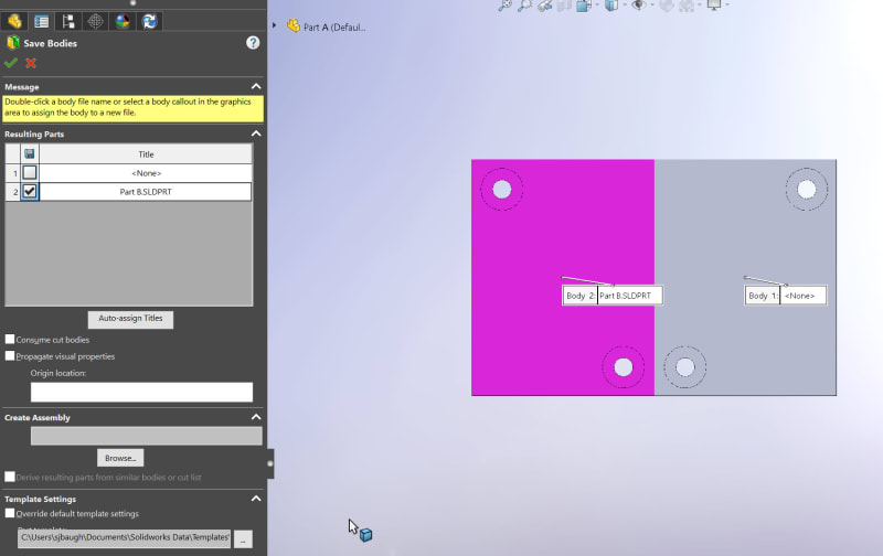

What I usually do when I want an exact mirrored copy of the part and it be a separate file.
1) I make one file and mirror the body (do not Merge).
2) Do an Insert\Features\"Save Bodies"
3) Select the mirrored body give it a new name and click OK.
4) Go back to the original file and do a delete body command and select the mirrored body.
Now you have two mirrored bodies, 2 different files. Granted the Mirrored body is directly controlled by the original one that made it. You can break the references but if its a mirror I wouldn't recommend it.
If your features have any "end conditions" other than "Blind" with a dimension to control the depth, then that would cause the features to not mirror properly.
