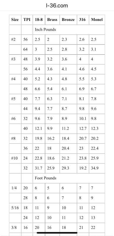

1). What is the maximum tightening torque for brass bolts of M10 size ? I want to
tighten brass bolts on brass earthing bar.
Could you recommend a comprehensive data sheet/table for this purpose ?
Thanks.

Is this right torque. I have searched the net for Brass bolt torque chart but not found.

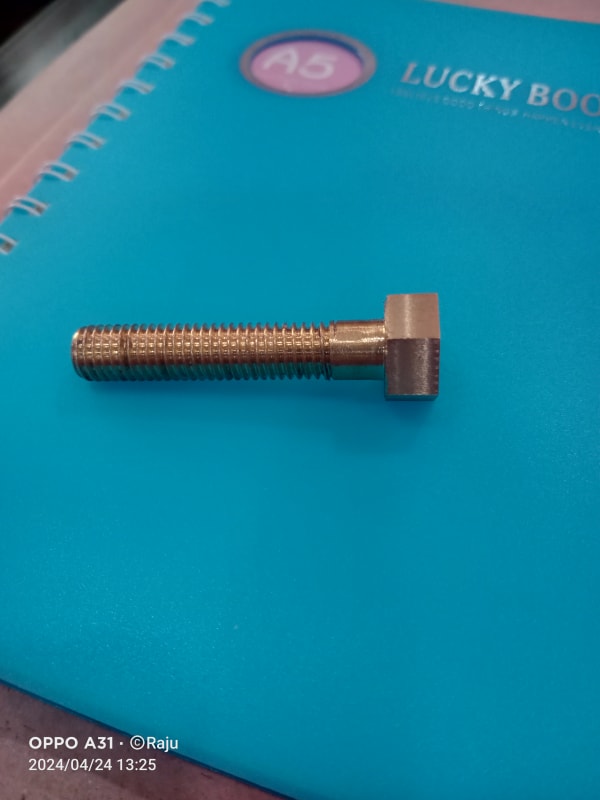

The fastener in the picture looks to have been hand filed to shape. It doesn't look like it is made of brass.
