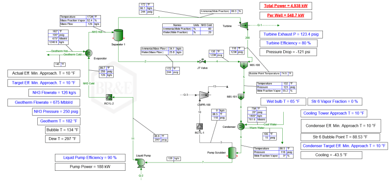

Hi, I have a pressurized 80% ammonia/20% water stream @300 psig/180F. Fluid is pressurized with a liquid pump (it's condensed before entering the pump) that we can fully control, so we expect to be able to maintain a stable pressure on the fluid (we don't expect any pressure swings). Also the system is closed loop, I don't think we will ever expect a surge. The pressurized stream is two phase (approx. 50%/50% vapor/liquid) at the 2-phase separator inlet.
So the normal operating condition for my separator is around 300 psig, and we don't expect this to fluctuate too much. I need to submit RFQ for separator design to manufacturers, and also design a relief valve system. I have a software that can do separator sizing, but by default it sets the MAWP as my operating condition.
Q1. What should I give to the manufacturers for MAWP? (If your answer is "depends", please give some detailed examples).
Q2. What's the difference among operating P, design P, and MAWP?
Q3. I'm thinking of setting a spring relief valve at 10% higher MAWP, and a rupture disk at 21% higher MAWP. Am I doing this correctly?
This is my first time ever doing an equipment design, any help is greatly appreciated.

@georgeverghese
The attached is my PFD. I'm the process engineer (entry-junior level) that designed this. The PFD describes a kalina cycle (meaning that it uses ammonia/water mixture as working fluid) geothermal plant. I do not have a P&ID. I am tasked with learning & designing P&ID, but I barely have any experience with it. I have decent experience with process sim tho. My employer wants me to learn P&ID so I can grow more into that field. The plan is to have me learn & design a preliminary P&ID and hire an experienced P&ID consultant and have him check my work.

This is a pretty big system!
Location of Relief valves will depend on where you have isolation valves, but yes you need to consider all this.
Your simulation says Pop=250psig, but I will use 280psig as you suggest as normal operating pressure. How about this:
Separator pressure-normal = 280psig
Control high pressure = 310psig - suction pressure control high for downstream turbine
High pressure blowoff PIC (backpressure power turbine suction line from gas exit of this sep)to vent setpoint in case of power recovery /backpressure turbine trip = 330psig
High pressure alarm = 360psig
High pressure trip = 390psig - PSV simmer - Max Operating Pressure(MOP) - stop the feed pump and stop heating medium at HX and trip backpressure turbine
Process design pressure = conventional type PSV setpoint = 390 x 1.1 = 430psig
To size PSV, use 10% overpressure for non fire reliefs or 21% overpressure for firecase - check local regulations to confirm

wow thanks for a great detailed answer. This really enlightens me on things I haven't thought about. I have a few things that need clarification to understand due to my lack of experience...
1) Control high pressure = 310 psi
Is this the suction control valve setpoint to ensure the fluid pressure entering the turbine is always below 310 psig? So if the pressure is above 310 psig, the valve will choke to reduce pressure to approximately 310 psig?​
2) High Pressure blowoff PIC = 330 psig
I don't understand the purpose of this. Why is there a need to shutdown the turbine because the pressure went up to 330 psig? Is this because you are assuming that the turbine rated for Max 330 psig and that exceeding this limit will damage the turbine? Also, if the suction control valve is working properly, I shouldn't see 330 psig right? So this 330 psig is a secondary safety device?​
3) Would it make sense to devise some bypass system in case of turbine trip, instead of blowoff valve? Because it's probably better to keep that ammonia in the system than venting it to air?
4) Where do you recommend installing the PSV? On a HP separator, HX, or somewhere else?
Looks like the recommendation you gave has 3 stage pressure management: suction control valve, blowoff valve, and then the PSV, and potentially an additional 4th valve for fire case. This level of detail is something I never thought about, really appreciate your insight.
1)Yes, you could use this suction control valve to maintain an upper limit to turbine inlet pressure. So this would be a high set PIC sitting on the turbine feed line to throttle the PCV upstream of this PIC. This would be a low dP control valve which is normally full open.
2) This is meant to for some reason where the turbine has accidentally tripped or reduced its speed through its own controls
On second thought, your idea is better to avoid the loss of precious ammonia to the vent. So instead of venting this excess pressure when turbine has dropped out or reduced its speed, it would be better to use this to override the LIC output going to the LCV which would be downstream of the ammonia vaporiser. So feed to this separator would be reduced, backing up level in the source vessel feeding the pump. Level in this source vessel will then rise.
3)See (2)
4)Obviously PSV would be on this separator ? You can use this same PSV for both non fire case and firecase reliefs. It is the permissible overpressure used in the sizing of the PSV that differentiates non fire and firecase reliefs. PSV setpoint remains the same, RELIEVING pressure ( which is set pressure(fixed) + permissible overpressure) which differs for the 2 cases.
