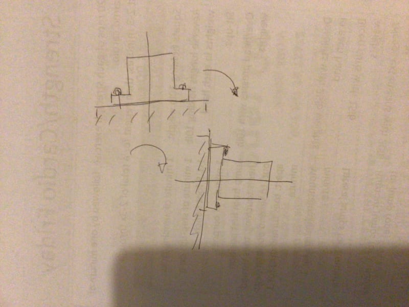

I have a cylinder rotating about its base.
When I decelerate to a stop is there a point where the ratio between the mass at the outer fibers and the center of gravity make a difference in calculating the reaction force?
The cylinder base is bolted down with four bolts and I am calculating the design factor on the bolted joint.
I was recently told this matters and want a second opinion.

The cylinder has a flange on the base that is bolted to a tilting table. Imagine the cylinder axis being perpendicular to the floor and then tilted by the base until the axis is parallel with the ground.
Assume the bolts are equally spaced with one at the 12 oclock position.
I am looking for the difference (if any) from calculating the reaction force when tilting a cylinder that has a D/d=1 vs D/d=4.

How fast does this table tilt? if its very slow you don't need to worry about deceleration.

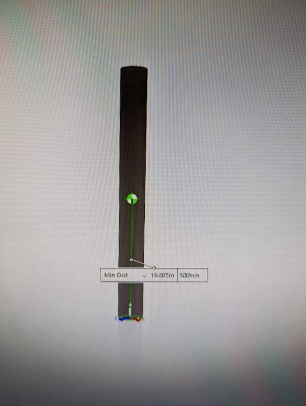

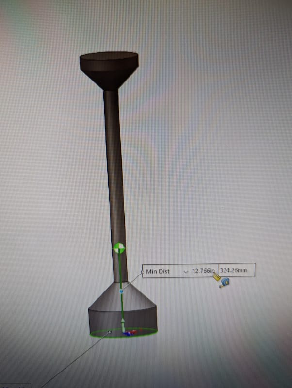

The question is about identical moment of inertia values but mass distribution changing.
Does the reaction force change based on D/d ratio from center of mass as shown in my first message?
Or does this ratio indicate when additional calcs are required to handle non-uniform mass distribution.
Both images below have identical Izz of 20.6 kg*m^2 and are both 1 m in height. The D/d ratio changes from D/d=1 on the nominal cylinder to D/d=2 on the odd looking part.

D is distance from top of part to center of gravity.
d is distance from bottom of part to center of gravity.
The bolts themselves are not relevant to the question and can be ignored, I only mentioned them as a description of how the real part is attached to the tilting table.
The force required to hold the cylinder in place during decel is what I'm looking into.
I want to know why I was told the odd shaped part would need a larger force to keep it in place even though the mass moments of inertia are identical. (I tried to get answers from the person who told me this but they did not really have an explanation other than to just expect larger forces when D/d increases above 2.)
Moment of inertia and total mass are the same.
CG height is different as shown.
The force depends on the acceleration profile. It can be anywhere from zero to very high.
Energy is 1/2 I w^2 + mgh. If h, the distance the CG travels, changes the energy will also change.
Yes, the CG height is lower on the strange shaped part. Which made me believe a smaller force is required to hold it in place since the inertia and mass are the same as the cylinder.
But I was told the reaction force would actually increase, even though the CG is closer to the mounting end of the part. This doesn't make sense to me at first glance.
However, the engineer that told me this has many years of design and lab/field testing experience. I think it would be a mistake for me to just ignore the statement because it doesn't align with the basic energy equation. I believe I am missing something (probably obvious) that would explain this.

What equations are you using to determine the force at the base? Would it not be the sum of the dynamic force due to acceleration/deceleration plus force due to static weight of cylider, and resulting/force moment reaction at the base for both of these forces?
Dynamic Force of acceleration/decleration:
F = M*R*A
F = Force in pounds
M = Total mass in slugs Weight/g
R = Radius of motion of C.G. in feet
A = Angular acceleration dW/dt = R d2Theta/dt2 in radians per sec-sec
So this produces a shear force and moment about the base. The shear force is same but the moment will increase with R. If R doubles then moment will double and so will opposing forces/moments in bolts.
Same for gravity reaction force - as R increases, shear force is same but moment reaction forces increase.
So if D/d doubles the moment reaction will half.
