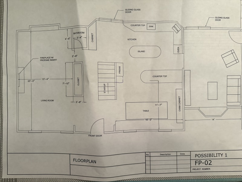

I'm currently sizing a beam to take out a load bearing wall in my own home (to open up between the kitchen and dining room) and have a couple questions about how you size for deflection limits when removing an existing wall, on new construction we size for live load deflection as the dead load deflection wont effect the finishes, but since this is a finished structure should I size the beam to deflection from the combined load, otherwise when we put up the beam and remove the supports the beam will deflect and the upper floor will settle from the dead load deflection and could mess up some finishes or the levelness of the floor above. The span is 16'-6", and it will support a bathroom on one side with a 14' joist span and a bedroom on the other with a 12' joist span, so the tributary width is 7' from the bathroom and 6' from the bedroom, also there is a partition wall that is not load bearing above the existing load bearing wall.
I am getting a live load of 460plf and a total load (live + dead of) 745plf with everything considered (40psf LL bathroom, 30psf LL bedroom, 15psf deadload both in case we ever switch to porcelain wood look tile in the bedroom, plus a few other loads we have), I'm winding up with a 14" or 16" in parallam beam, which I likely won't do because it's 2x8 framing on the floors and we don't want the beam sticking down that far. The limiting factor is deflection limits, not moment or shear. So the question become because it's a long span with tile above in the bathroom do I use L/480 or L/600, and do I use live load deflection or total deflection, L/480=.415" L/600=.33 inches, I'm worried if I size for live load when we remove the supports any settling will disturb the floor above.
Am I being grossly over conservative by sizing for L/600 for total load deflection. Since it's my own home I don't want any chance of the floor bouncing or settling, the house was already built cheap by the builder in the 80's and I'm been improving everything in it as I've been living there.
It seems no matter what I'll have a little of a bump down in the ceiling where the beam is as it's only 8" framing and I'll have to go with a W8 of some weight. I don't mind sizing it a size up as I will be supplying and furnishing the steel myself, just curious for any input as I don't really do any residential work.

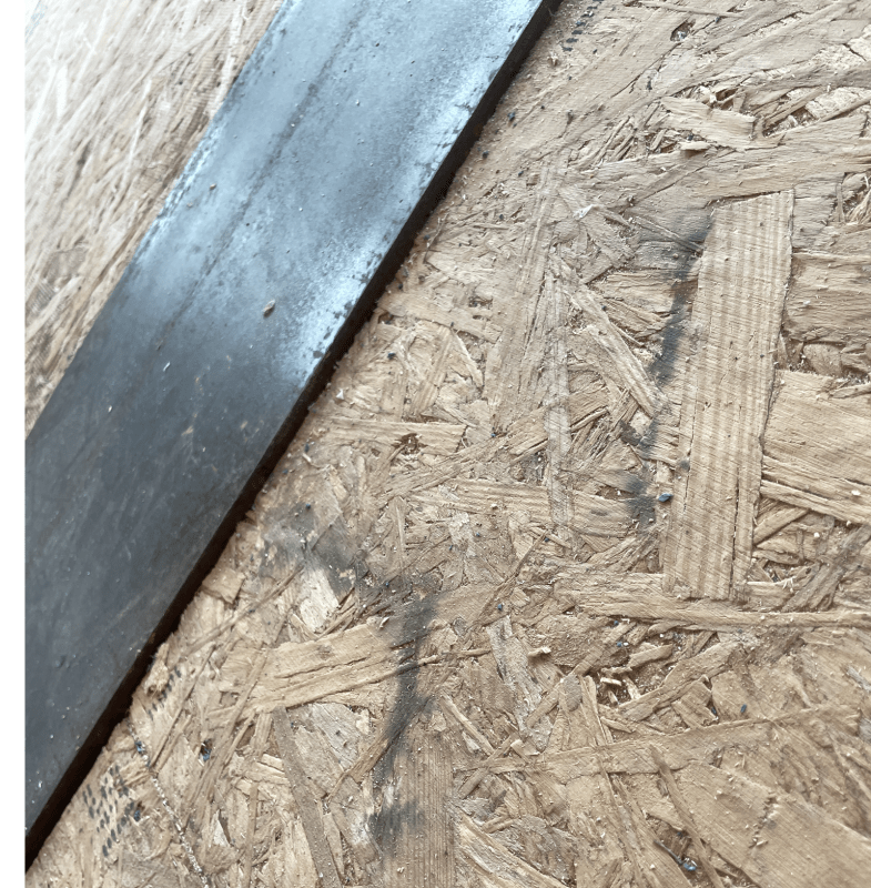

Also I always recommend adding a top flange nailer. Plywood right on a steel beam is a squeaky setup. You'll be cursing yourself forever if the floor squeaks upstairs everytime you walk over the beam.

Regarding the nailer - as long as you keep the beam down 1/8" to 1/4" from the floor sheathing, you'll be fine without it if you're using packing and face hangers. That way you don't have contact between the plywood and the steel, if there's any shrinkage/settling of the framing into the hangers you won't get a high spot. Shrinkage is unlikely as they are existing and EMC is stable, but settling will happen if they aren't seated just so.

DS, to answer your question, a nailer is obviously better when the subfloor gets nailed to it above, but if it's just a first floor reno, I still specify the same unless they really need that inch back.
A nice piece of wood between the top flange and the plywood above not only gives you less squeak potential, but it also allows for a little adjustability on the total height of the system. Can always shave it down or build it up to line things up. These homeowners aren't getting the top of the line steel contractors putting up their living room beams.

You’re right it would likely never see the full load since it’s a bedroom on one side and master bath on the other, and the tub and shower are on the other side of the joist span right next to the exterior load bearing wall, so it won’t take much load ever from that end either. I’m definitely just overthinking this because it’s my own house and I have to live with it.

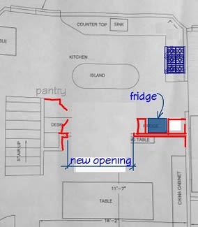

I attached a rough current floor plan and a floor plan we’re considering just for the sake of it, the beam would go where the current wall is between the kitchen and dining room that the desk, oven and refrigerator is currently against, there is a void behind the desk where currently is the air return to the AC air handler in the basement. The beam would span from the wall where the stairs are on the left end of the dining room to the wall on the right side of the dining room where the oven currently is.

This is slightly off topic, but I can never understand why having a flush/hidden beam is always so important to people, with the exception of there being an actual head height issue. It seems that this is a major concern of clients/owners on about half of projects. In the end, they end up with a vast, unbroken plane of ceiling spanning like 30 or 40 feet with no visual interest. If the drywall job isn't perfect, it's really noticeable over such a length. My ideal aesthetic would be something along the lines of the beam sticking down 6 or 8 inches, which would coincide nicely with a steel beam deep enough to likely limit deflection to 1/8" or so. This is of course subjective and just my opinion.
a few thoughts:
[ol 1]
[li]-sometimes its better to go with an absolute number for deflection. Keep the dl defl low because these will be actual cracks in your existing drywall upstairs. LL deflection can be a reflection of the existing stiffness of your house.[/li]
[li]-be mindful of the location of the posts. I think its' better if the posts miss the existing footings because then you don't have to justify the additional load on the existing...you just install a new footing. Hiding them in the wall like you show makes it much more difficult.[/li]
[li]-You may want to stiffen the floor in the new big space while you're at it.[/li]
[li] another idea: could you put an 18" lvl in the attic and hang your beam from that?[/li]
[li]-You didn't ask, but in my opinion a big room with a low ceiling is out of proportion and an 'open concept' kitchen/dining is not necessarily the improvement people hope for. An alternative would be making a wider cased opening that has better lines of sight from one space to the next and lets you use your dining room for eating instead of the new giant piece of stone counter[/li]
