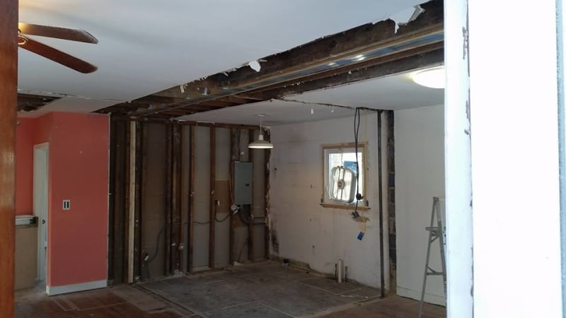

I'm currently sizing a beam to take out a load bearing wall in my own home (to open up between the kitchen and dining room) and have a couple questions about how you size for deflection limits when removing an existing wall, on new construction we size for live load deflection as the dead load deflection wont effect the finishes, but since this is a finished structure should I size the beam to deflection from the combined load, otherwise when we put up the beam and remove the supports the beam will deflect and the upper floor will settle from the dead load deflection and could mess up some finishes or the levelness of the floor above. The span is 16'-6", and it will support a bathroom on one side with a 14' joist span and a bedroom on the other with a 12' joist span, so the tributary width is 7' from the bathroom and 6' from the bedroom, also there is a partition wall that is not load bearing above the existing load bearing wall.
I am getting a live load of 460plf and a total load (live + dead of) 745plf with everything considered (40psf LL bathroom, 30psf LL bedroom, 15psf deadload both in case we ever switch to porcelain wood look tile in the bedroom, plus a few other loads we have), I'm winding up with a 14" or 16" in parallam beam, which I likely won't do because it's 2x8 framing on the floors and we don't want the beam sticking down that far. The limiting factor is deflection limits, not moment or shear. So the question become because it's a long span with tile above in the bathroom do I use L/480 or L/600, and do I use live load deflection or total deflection, L/480=.415" L/600=.33 inches, I'm worried if I size for live load when we remove the supports any settling will disturb the floor above.
Am I being grossly over conservative by sizing for L/600 for total load deflection. Since it's my own home I don't want any chance of the floor bouncing or settling, the house was already built cheap by the builder in the 80's and I'm been improving everything in it as I've been living there.
It seems no matter what I'll have a little of a bump down in the ceiling where the beam is as it's only 8" framing and I'll have to go with a W8 of some weight. I don't mind sizing it a size up as I will be supplying and furnishing the steel myself, just curious for any input as I don't really do any residential work.

That’s exactly what I’m going to do at this point, I wasn’t sure if I was being drastically overconservative with the deflection limits I was trying to meet, and from the different opinions it doesn’t seem like I am, I was trying to fully hide the beam in the ceiling, but I’d rather just upsize it a little and be positive I’ll have no issues.
It’s my own house, I’m sizing the beam, I’m field measuring and fabricating it in my shop, and my crew of ironworkers will install the steel (again overkill for residential work lol), if there was any issue it’d be 100% on me and I’d have to live with it. I’ll just go with a W10 or W12 that I know will have almost zero deflection issues and clad it to look like a wood beam and never have to worry about it.

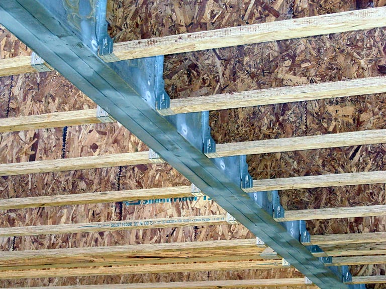

We might be able to manufacture a beam that is 7 1/4 depth. I ran some preliminary numbers and it does work. We just need to get some additional information. I read your post and not all the others since this thread was several days old. visit Metwood.com and check out our TUFFBEAM product
What are the section properties for this beam to get it to work based on the above requirements? Based on the load chart from your website, it doesn't look like a 7 1/4" deep beam will work. I'm also curious how you would support wood joists in a flush mount condition.
TUFFBEAM! That's it. I was trying to remember your product a while back but couldn't. My former boss used one in his house - he was impressed with the performance and ease of installation (he self performed - his father was a GC and he spent his formative years erecting metal building systems before becoming an SE). Couldn't remember what it was called, though. Filing that one away for future use...

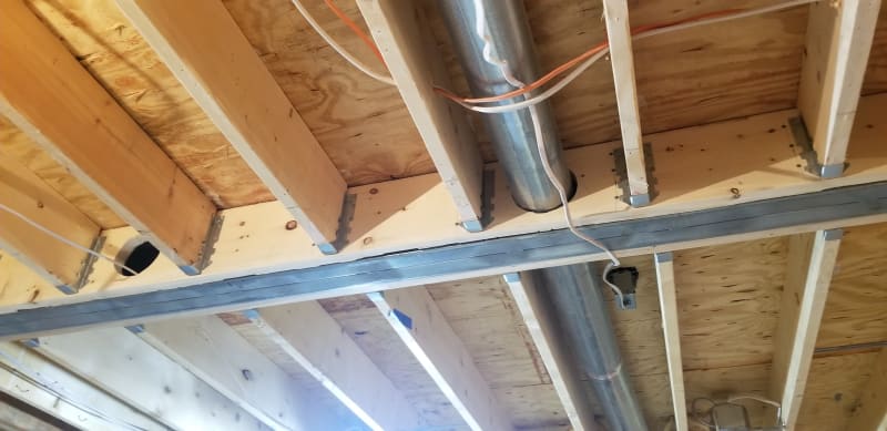

We would have to use a three or 4 ply to get 7 1/4 to work. However, I have the ability to camber our beams to help with deflection.
The joist hangers would fasten to the side of our beam with self drilling screws or we can add wood to the side so the hangers can be nailed on. Keep in mind, if you need a hole for passage, I can put up to a 4" hole anywhere along the beam you need it.
I prefer the direct to the side with self drilling screws.

Wouldn't it be hard to install if you camber it for this application? Probably better for new construction?

XR - not much availability problem for us. They're located in Roanoke. I know of at least one installation here in Hampton Roads.
MetwoodBS - what does your distribution network look like? Are you mostly special order, or are you stocked in building supply warehouses?
We ship product across the country. Everything is fabricated in Virginia. We now have the ability to build our beams to be field trimmable up to 2' feet. We have a discounted rate for shipping with T-Force through a members discount program by being members of the National Association of Home Builders.
Doublestud questioned about installing with camber - It works best for new construction because of the time and loading being added over time. However, Camber in some instances can help remove the bounce and in most cases doesnt need to be more than 1/4 or 1/2.
XR250 - Web Stiffeners are already installed when we fabricate our beams. That eliminates the possibility of a framer forgetting to add.
