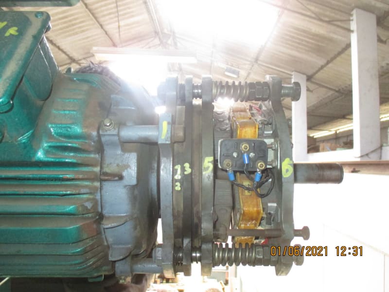

Our present 10 ton hoist motor is two speed two winding rated for 415V, 12/4 HP, 1440/465 RPM with electrically operated spring brake as shown below.
To reduce the high inrush current of about 80 Amps, I plan to rewind the motor for single speed 16 HP/25 Amp/1440 RPM and use a VFD.
The VFD will have two speed settings for 1500/600 RPM with pendant and as well radio controls. The exiting electrically operated brake will be retained.

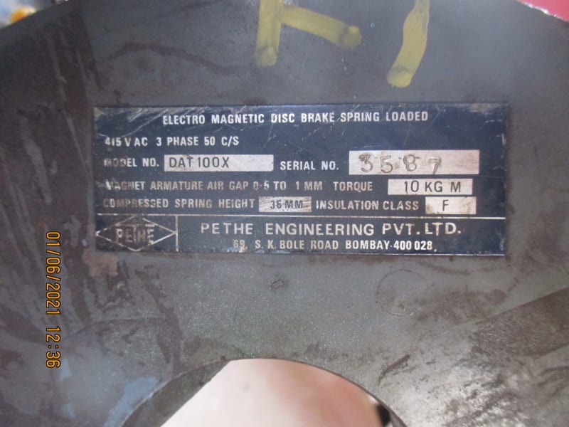

The electromagnetic spring loaded disc brake is attached to the hoist motor NDE as shown below. The 3 ph AC brake coil is energized when the Up/Down contactor is ON and the brake gets disengaged and then gets reengaged via springs with the Up/Down contactor is OFF.

On VFD operation the electrical brake is operated by the VFD.

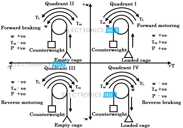

The counterweight in the picture is not usually a feature of a hoist. Here is another picture of the concept

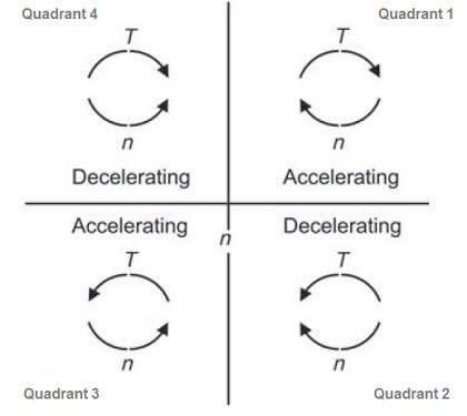

Steady state operation of a hoist is in quadrant 1 and 4. Operation in 2 and 3 occurs when accelerating the load.
Lowering a load when a load brake is present, the torque is absorbed by the load brake, and the hoist motor never sees any regeneration energy from the load (quadrant 3 operation). On stopping, dumping the energy of the spinning motor can be handled the same with the new VFD as it is currently, by setting the motor brake whenever power is removed from the motor.
For a hoist with a load brake, where only a small number of speeds will be available for selection. I would use a hoist rated drive programmed for constant torque operation. Encoder feedback is not necessary, and neither is torque proving (the load break takes care of the issues torque proving solves). Most hoist rated drives have connections for the motor shaft brake. A breaking resistor may still be needed, it's VFD design specific, but if needed will be small, as only the rotational energy of the rotor and the components on the motor side of the load brake can end up in the resistor. The resistor is to prevent any possibility of a drive trip on DC Bus overvoltage.
