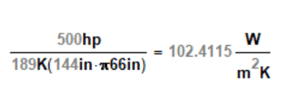

The bottom line is that 373 kW needs to be removed from cylinder. Using 11 C air temp, you'd need 102 W/m^2-K convection coefficient to get the required surface temperature, which requires something on the order of ~17 m/s air velocity, which is 38 mph air speed, according to the chart below, from I can't speak to the veracity of the chart from the paper, since the Engineering Toolbox chart would seem to imply needing something closer to supersonic airflow.

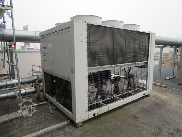

Trusting Snickster's calc as a decent starting ball park, this is what a 105 ton chiller looks like:

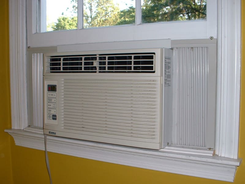

However, from your "On one face of the cube is attached an AC" I have the impression that your expectation is something like this:

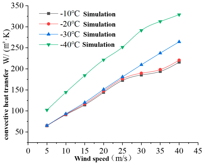

@IRStuff: The air temperature of that chart is a long way from 350°F.
The chart is showing air temperature, not surface temperature. However, while the desired surface temperature is 200F, the exit temperature isn't anywhere near that high. Assuming a 6-inch layer air interacting with the surface, I get something like 43C temperature rise, so earlier calculation works with approximately -30C supply temp.

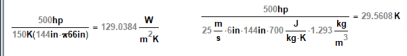

If we take the temperature rise into account and use 25C air, then we'd assume something like 50C average air temp and need something like 25 to 30 m/s air flow, since the convective coefficient would need to increase to about 130 W/m^2-K. At 25 m/s flow rate, the outlet air rise temperature should be around 30C.
It's hard extrapolating from the chart, so there's lots of opportunities for error factors of 2x; regardless, the calculation approach would be the same, just with different convection coefficients and different air velocities.

Let me put it in more perspective. 500Hp is 373KW. I am not sure why that is odd to note. It's an electromechanical system. Some amount of voltage is applied to convert it into mechanical power. Some power applied is lost in heat which is 500 hp or 373 KW. This loss of heat or heat generation is continuous. The temperature inside the cylinder is 350 F initially because of the heat.

OK, then what I calculated is basically the approach.
> you use 500 hp to determine the heat transfer coefficient required of the cooling configuration, and you might need to adjust the surface area downward to account for the flow inefficiency
> you then use the thermal mass capacity of the airflow to determine the linear velocity or volumetric flow of the air and iterate the assumptions as needed, including the boundary layer depth.
So, note that my last calculation wound up with a 56 mph linear velocity, which is pretty crazy; note also the volumetric flow of about 30,000 cfm, which is likewise crazy. These suggest that you need a MASSIVE cooler with an outlet temperature below 0 degC, like say -30 degC. However, since that's below freezing, there will be a crap-ton of condensation to deal with, which does suck cooling capacity from the air stream.

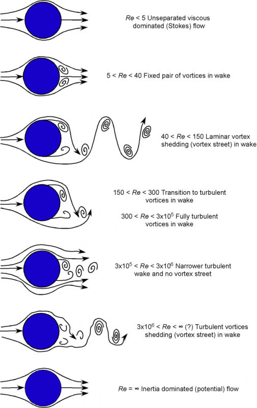

Both Snickster and IRstuff are assuming that all of the air flowing through the enclosure will have the same effectiveness at cooling the cylinder, and that isn't the case.
In "ideal" conditions, air flowing over a cylinder looks like one of these cases:
Your case is far from ideal.
Much of the air will not contact the cylinder at all. Much of the cylinder's surface is likely to be exposed to relatively stagnant eddy's, and thus have a far lower convective coefficient that IRstuff shows that you'll need.
I'll join LittleInch in saying that air cooling probably won't do the job.
