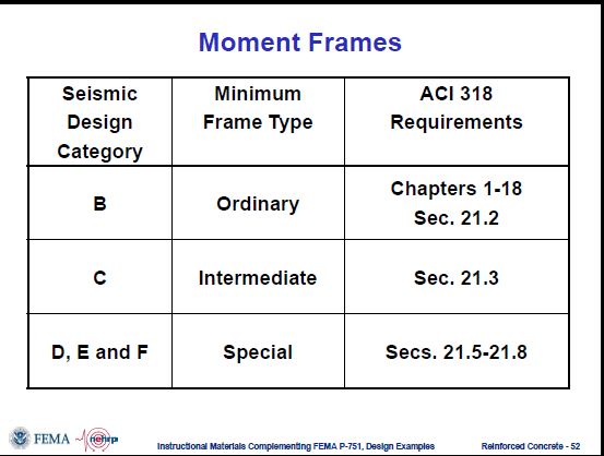

What is the criteria to choose between ordinary, intermediate and special moment resisting frames? Please provide reference from ACI?
Better to look at ASCE 7-16 - regions of higher seismicity have stricter requirements depending on building height which will push you out of ordinary and intermediate.
Refer to ASCE 7 Table 12.2-1 Design Coefficients and Factors for Seismic Force-Resisting Systems , and permitted structural systems.
I f you are looking for RC frames, the following table is the summary :
