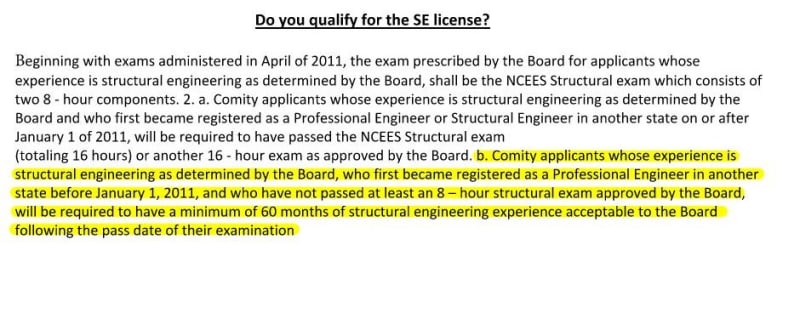

It's a little more irritating when you read this clause from the PE license application form. So my slightly older colleague, who only took the regular 8-hour NCEES PE exam (same as me) and got PE licensed in 2010, is eligible to get his SE designation in Georgia, but I'm not. WTF Georgia?

Second, is it a P.E. or an S.E. that is required in Georgia for delegated connection design. Interesting question. I've done connection design as the delegated design engineer, but not all that recently (8 years already?) and not in GA. But I do have a 16 hour S.E.
While it's perhaps possible somebody with a Structural-I license from out of state would be able to get an S.E. in Georgia without taking an exam, the likelikood they have 60 months ... never mind. I don't understand clause b. It looks kind of like a grandfather from another state, like, say you had an S.E. in Illinois that you maintained constantly after getting it and had it before the 16 hour exam existed and it wasn't a Structural 2.
