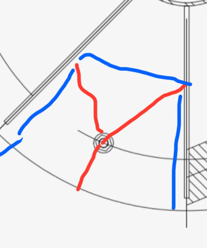

When using a high strength bolt clamping two pieces of metal together. What effective width do you use on each side of the bolt hole to determine the effective flexural width? Is there a value prescribed by code? or by common useage? I typically consider 4 x the thickness of the material on each side for a total of 8 x the thickness.
For a 1/4" thick plate, I would normally use an effective width of 2".
The way I was taught and have done it ever since is to consider a shear angle.
For example, if you have a 6" square HSS and a base plate with bolts at 9" each way, the distance from the center of the bolt to the HSS is approximately 1.5"xsqrt(2)=2.12". The approximation neglects the bend radius at the corner of the tube. If the shear angle is 45 degrees, then the effective width is (2)x(2.12)=4.14". Some might consider 45 degrees as unconservative. If the shear angle were 30 degrees, the effective width would be 2.45".
1/4" plate with HSB??
Thanks... the bolt is in a metal base plate securing a post, with gusset plates. The span is the distance between the gusset plates with the bolt located at mid span. I'm assuming the width of the section as 8x the thickness to determine the plastic section to develop the moment resistance of the base plate.
This is the condition.

Need BA’s yield line knowledge but with the gusset configuration this seems like an appropriate yield pattern:
Thanks Celt... I'd normally do a yield line solution; I was looking for a quick simple solution... just a span and a tributary width to calculate the Mp... The span seems simple enough and I usually use 8x thickness for a trib width. I was wondering if others had any other trib widths.
the failure lines that Celt drew are only for the location where fastener is in tension. but I still doubt those locations are more critical than pull thru of the fastener thru the plate locally or failure of the fastener in tension.
The fasteners will not go into compression... Base plate and gussets look after that.
IMO, 6t is more reasonable. I agree with Celt83 (Structural) solving with yield lines and a PBS for his post.

Thanks... it works with 6xt also... If I had lots of them to do, I'd use a yield line approach...
