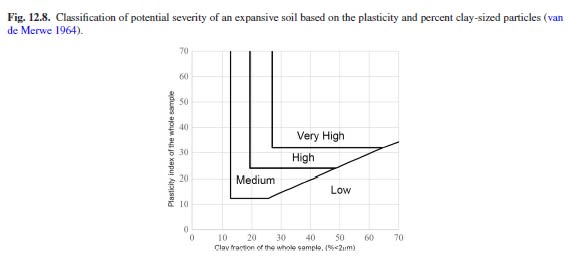

To your second question based on the below chart from 1964 PI of 9.6, clay fraction of 64.9% low potential, this really doesn't mean much though as the minerology for various clay minerals have different swelling potential. This is why the local geotechnical engineer would be best suited to inform you of the potential risks from expansive behavior of the clays found in the region.
If you're required to do expansion tests you should probably do them. We wouldn't consider a PI of 9.6 to be expansive, but your geotechnical engineer didn't do Atterberg limits on the material your foundation will be resting on, so you really don't know. We have expansive shales in my area.
