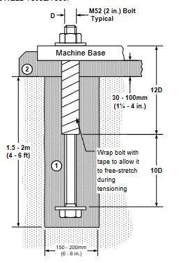

Effective embedment length for partially debonded anchor bolt
BridgeEngineer21
Oct 26, 2021
77
DK
I am reviewing a proposed connection for a tower foundation that has the detail shown in the sketch below. The contractor wants to use corrosion protection tape at the top portion of the anchor bolt. They did not provide any info on the tape, and from the manufacturer's website I can see it is mainly geared towards wrapping pipes and things like that so they don't give any structural properties or friction coefficient for it.
Therefore, I believe the length of the anchor bolt covered in this tape should be assumed to be completely debonded from grout. This means that for anchor bond strength, only the length ld,effective should be counted on.
Now my question is, what about for other checks such as pullout, breakout, or pryout? Intuitively, it seems those are all based on the depth of concrete (or in this case, grout and rock) above the bottom of your anchor, and there's no need to discount the debonded portion of the anchor. But I've never dealt with a case like this before, and would like to get a little confidence with some second opinions.
A related question is having to do with the check of bending in the exposed portion of anchor bolt. Intuitively, it seems the moment can just be V*e1, since below e1 the compressive strength of the grout should prevent the bolt from deflecting at all. But then I looked at the situation as basically equivalent to the one sketched below, which I again have never really analyzed before, and now I'm a bit in doubt if I'm not missing some other aspect.
Would appreciate anyone's thoughts on this.

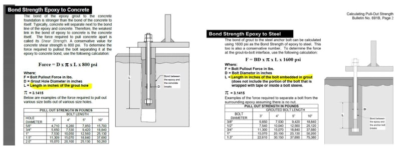

have a look at this literature from Chockfast see p. 7 of the document.
Thanks for sharing dvd, interesting read. It confirms my thinking about bond strength. But in the section about pullout strength they don't directly address if the embedment length would be effected by having anchor tape.

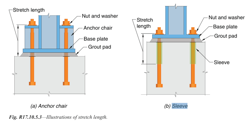

However the main value I got from this is to remind me about anchor sleeves. While I haven't designed with those before either, I'm much more familiar with seeing them in my typical line of work. I took a look into ACI 318 and Eurocode 2-4, and found that both of them only address sleeves with regards to "stretch length" for seismic design (example from ACI below), which I think should be similar to e2 in my case (though of course, in a case where I actually needed to count on the stretch length to allow some displacement, then I would go with only e1, since maybe there is more bond than I think with this tape). But I couldn't find anything about how this stretch length effects embedment length.

Those pages are talking about bond strength, and they are helpful just to confirm my assumption about how I should account for bond strength. But bond strength is not what I had doubts about. My doubts are related to other cases such as pullout or breakout, as well as bending in the anchor bolt.
Idle interest from an EE here. The linked document speaks of the bond strength of epoxy grout to concrete, but the OP has the grout in rock of an unnamed type. Seems like this detail might make a difference.

There is some difference between an grouted/epoxied anchor with a stretch length (tape or sleeve) and a headed anchor. In the case of the headed anchor, where all of the anchorage force is delivered at the bottom, it makes sense that other failure modes like breakout and pryout would be unaffected. In a grouted or epoxied anchor, where the anchorage force develops across the effective length, perhaps there is some effect. If the stretch length were 25% of the total, I wouldn't lose sleep over it. If more, perhaps you account for it (although I'm not sure how).
Bond or pullout could be affected, but a breakout cone wouldn't be. Your breakout cone isn't smaller because of the reduced bond along the top part of the cone. The bottom part of the cone would still need to come out through the area that the top of the cone exists in (i.e. you can't just breakout a shear cone in the bottom part of the anchor without the top part coming along for the ride, even if the part around the anchor is debonded)

THLS, I'm not sure. Would the changes to the stress field when partially debonded change the assumed geometry of a breakout cone? It feels to me that it might -- most likely making it more similar to a headed anchor, but I'm not confident enough in my understanding of this scenario to say that for sure.
Does anyone have thoughts on the second part of the question? Is bending affected at all or is e1 for the moment arm still valid?

The fixity question is a tricky one, especially with the wrap. I think there are equations for the depth to lateral fixity for bars/bolts embedded in concrete, but I'm not sure where to find them. However, that depth would increase some because of the wrap, and it would vary depending on how thick/tight the wrap is at the surface of the concrete. We avoid that whole dilemma by keeping our leveling nuts less than a bolt diameter from the top of the concrete, which allows us to ignore the effects of bending, per the AASHTO sign spec.

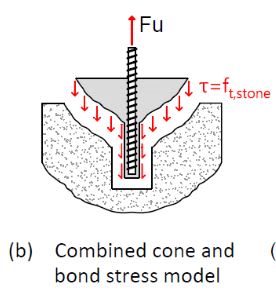

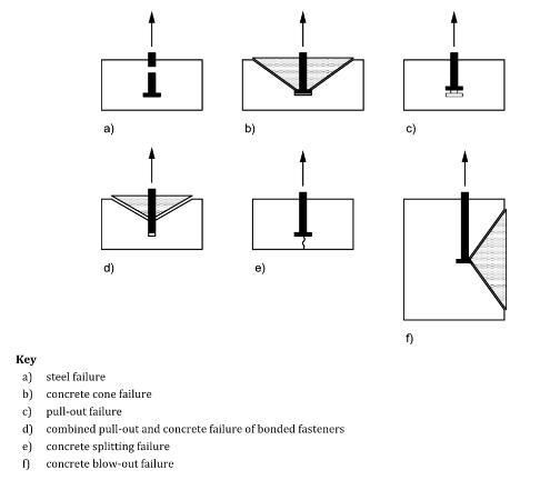

Eurocode (EN 1992-4) is a little less explicit, but is the governing code I have to follow here. I am thinking that the combined pullout and concrete cone failure mode, as you posted above, is the main failure to check here. I'm wondering if there's any significance to the fact that in the Eurocode figure that's the only failure mode they showed a non-headed anchor with..
I guess the failure angle of the "rock" cone would then depend on the joint inclination angle of the rock
