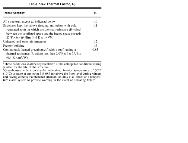

I am designing a group of buildings for a summer campgrounds in a high (~60 PSF) snow load area. The buildings will be unoccupied and winterized/unheated during the winter.
Buildings are risk category II
My thoughts regarding snow loads
1. Design snow load using a Ct of 1.0, Risk Category II
2. Use a Ct for unheated structures since the buildings will be unheated in the winter.
My reasoning to use Ct of 1.0 is that when the building is unheated it'll be unoccupied and arguably Risk Cat I. If the buildings end up getting used during the winter (not unoccupied) then they'll be heated.
Curious to hear others thoughts.

I mean the Ct factor in determining snow loads from ASCE 7
Ct from ASCE 7, not the NDS. Thermal Factor for snow load calculation.
I'd use 1.2 for my Ct. If one of these collapses, the owner (or their insurance company) will still be looking for a pound of flesh to offset their loss whether it was occupied or not. Skimping on this puts a real nice target on your back.

Doublestud - for houses, are you not doing any with attics? If you have an unoccupied attic, it should be 1.1 in most cases. Around here, the minimum R value for attic insulation is R-38 (though I think it just went up with the code change). So truss and conventionally framed gable roofs with unoccupied attics would fall under 'cold ventilated roofs'.
I tend to be on the conservative side, so I would most likely use Ct=1.2. I wouldn't even think about it unless it made a big difference with the roof framing, like if you couldn't get 2x12 rafters to work and now had to use LVLs, or something like that. Still, I'd probably just stick with Ct=1.2 regardless.
The flip-side of this is that your argument is logical, and the commentary to ASCE 7 mentions this exact scenario!
ASCE 7-16 said:
Some dwellings are not used during the winter. Although their thermal factor may increase to 1.2 at that time, they are unoccupied, so their Importance Factor reduces to 0.8. The net effect is to required the same design load as for a heated, occupied dwelling.
Now, if I was going to take this approach, I would still use Ct=1.2, but would use Is=0.8 for Risk Cat. I. Using Ct=1.0 and Is=1.0 makes it confusing/misleading if you'll be communicating that information, like if it's including with your general notes.

The point by phamENG is a good one. I also often use Ct=1.1 for insulated roofs.
If this is a summer cabin with no insulation (which is likely) then Ct=1.0 makes sense. But, if the cabins will at some point be used in the winter, I think there's a good chance that the owner would insulate the roofs making them Ct=1.1. If they're paying for the heat, they'll definitely have a strong incentive to do this. And if that's the case, all of a sudden the roof will no longer meet code if you design it per your method. If you do proceed this way, I would add a note on the plans describing this scenario.
