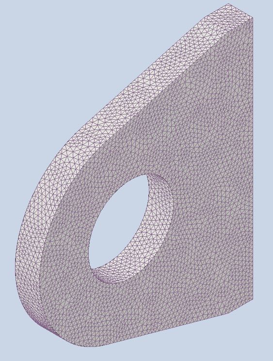

I did a simple analysis of the lifting lug by using 3D solid elements (parabolic order) and bi-linear material (LGDISP is on). The model performed pretty well and managed to reach the plateau (plastic deformation).

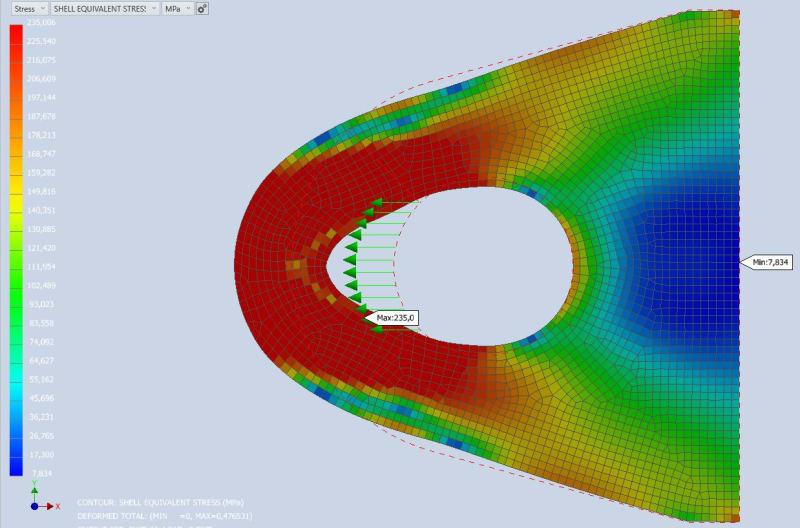

After that I tried to do the exactly same simulation but using 2D shell elements (parabolic order), bi-linear material (LGDISP is on). In such case during the analysis a plateau (plastic deformation) wasn't reached. Solver managed only capture the elastic-plastic transition and then stopped because of calculations resulting in divergency.
For both analysis I used same parameters, material properties and force. For 2D calculation I also tried to increase number of increments.
Maybe someone could help me out to figure out or share some insights what I did wrong in analysis where I used shell elements?

Isn't the load applied differently in both cases or are those equivalent load definitions ? The top on looks more like a uniform force and the bottom one like bearing load distribution.
Also, by 2D shell elements do you mean plane stress/strain analysis where elements have only 2 translational DOFs or full shell elements with 5 or 6 DOFs ?
As already har been said, the load is probably not applied in the same way. It looks like a more concentrated load for the shell model.
The software is what used to be called NEiNastran so I don't think the problem is the solver. However, how you apply load using Inventor is probably something you need to investigate.
Yes, the loading appears different in the two cases.
And, the loading in both cases is Wrong for a pin loading the hole. It would be better to apply a displacement to the hole edge matching a pin shape.

The #D solid model has several elements thru the thickness, yes? so this is different to the 2D shell model.

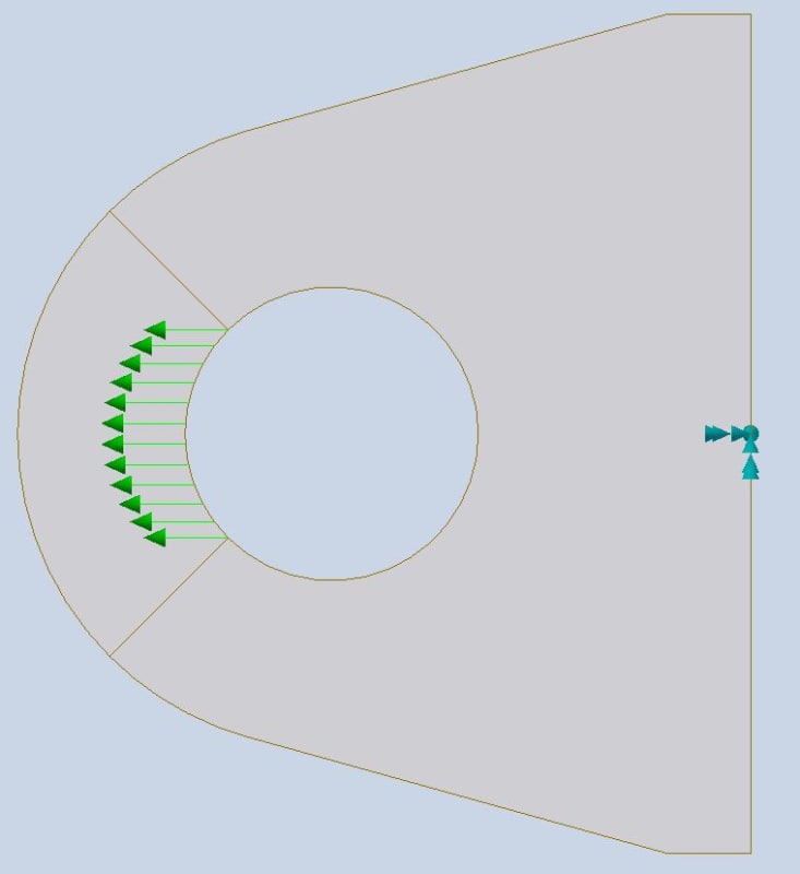

This is a full shell model with 6 DOFs. The picture that I uploaded regarding the applied load wasn't accurate. The density of load arrow representation was low, for this reason representation of load appeared like single arrow. Please find below the accurate representation of applied load.
The loads in shell and solid models differs. In the solid model I used the bearing load. In the shell model I used simple load, but crated the split so there would be an area (curve) on only which load is applied. I did another nonlinear analysis using shell model, the load was applied in different way. In such case solver managed to reach the convergence and plastic deformation (plateau) was reached. For this reason, I also believe that there is a problem with the way of applied load rather than with solver.

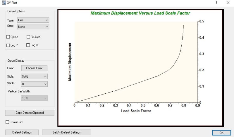

I just wanted to let to know that within the shell model there was reached quite similar results to the solid model that I'm happy enough. The changes that I did was increasement of the numbers of increments and bisections.
In the solid model the capacity of lug was reached around 239 kN. In the shell model the value was 245 kN. In the hand calculations taking into account worst case scenario for the shear of the lug, the capacity was 217 kN.
the big difference (AFAICS) was the 3D model had a markedly different stiffness curve, almost a brittle behaviour
rb1957,
I do agree that in solid model the curve looks quite off and it really does look more like brittle material behavior. I believe that this could be because of two factors.
The first one is the number of the increments. The solid model had less increments compared to the shell model.
The second one is probably because in solid model I used the value of the load 350 kN while in shell model I used 300 kN. That probably could had the impact on the scale of the curve. For this reason probably the shell model captured the curve in the elastic-plastic zone more clearly and visible.
I suspect a significant difference between the models is that the 3D model had several elements through the thickness.
I suspect too that you "messed" with the element formulation in that it looks like the surface of the shell is smaller (or at least of the same scale) as the thickness. This is probably "not good".
But when you say you're satisified with the two models, could you show the stiffness curve of the 3D element model ? did it "flatten out" like the shell model, or was there still the very sudden transition ?
I wonder what your material curve looks like ?

I believe there is enough elements through the thickness. Please see the picture below.

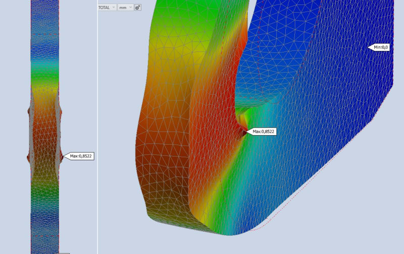

I did a little investigation of the results. I believe that the displacement results are effect at one point (sudden jump in displacement) because the pressure resistance (bearing resistance) starts to kick in. In such case some elements deforms not only parallel to the load, but also to the sides of the lug through the thickness. And I believe this is at least a one of the differences with shell model. Please see the picture below.
The deformation results are still completely wrong for a pin loaded lug.

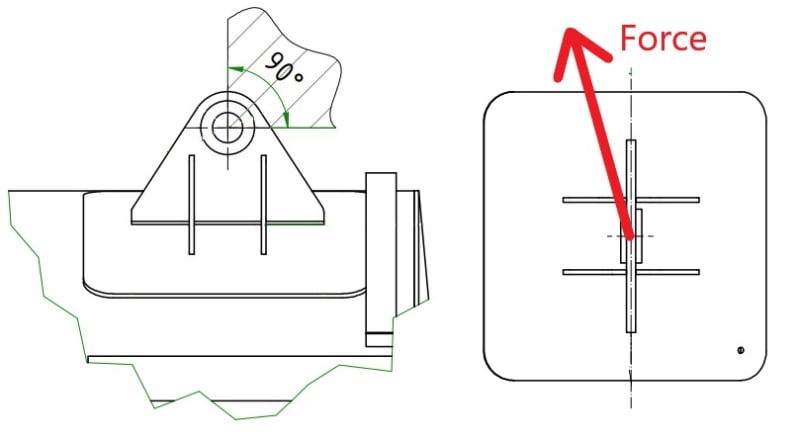

Also, one of the reason why I was interested in such calculations was that I'm not able to manage to find clear information how to calculate (by hand) lug capacity when lug is loaded by combination of normal force and bending. Perhaps you have any recommendations or insights how to perform such hand calculations?
To capture nearly right results of deformation I should model pin and contact between pin and lug. Having in mind that this should be done in Nonlinear analysis, that would be way too time consuming and way too complex for such task. This is a reason why I'm trying to find an cheap way of getting only approximately results of such case for an early stages of the design.
Do a google search for “air force lug analysis” and lots of useful info will come up.
By “bending” how exactly is the moment applied? By pin bending and non uniform contact thru the thickness?
Are you designing a specific lug? For what application?
And by shear failure, do you mean shear along lines tangent to the hole aligned with the loading direction? And note there are several other lug failure modes that must be checked.
As for modelling the pin, if you don’t want the headache of contact elements, then apply a enforced displacement field to the hole surface and extract the reaction force. If you want, check the forces at the enforced displacement nodes, release any that are in tension, and rerun. (Poor man’s contact modelling).

Please find attached picture regarding the bending moment. Basically there will be some lifting lugs that will experience not only radial forces but also some amount of axial forces because of force applied in angle.
By shear failure I mean "Double shear failure".
That's some really good advice, I was unfamiliar with such approach (enforced displacement and then rerun by releasing elements that are in tension). Seems really useful, I will try it out. Thanks a lot, it's a pleasure to learn such stuff here from engineers like you!
As long as the force is applied on the pin and close to the hole (the only sensible way to design this kind of structure), the failure will be due to bolt shear and bolt bearing against the plate. A simple method would the be to take the resultant of the force, apply standard formulas (e.g., AISC or eurocode) for shear of a bolt (pin) and bearing against the plate, and be done with it.
