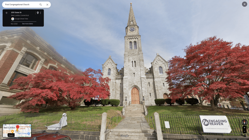

Tall stone Center steeple collapsed on historic 1850s Church in New London CT

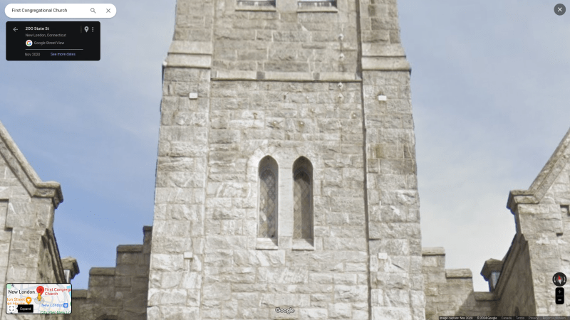

Big issues were already being addressed using thru bolts as far back as 2013: Google Maps
Not just the steeple, most of the church collapsed.
What do mean of thru bolt, are they PT "Post-tensioned" Rods ?
My experience is not normally PT, but they may have a slight load on them...

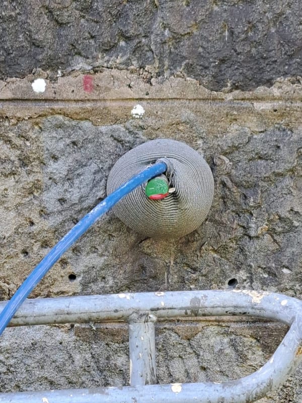

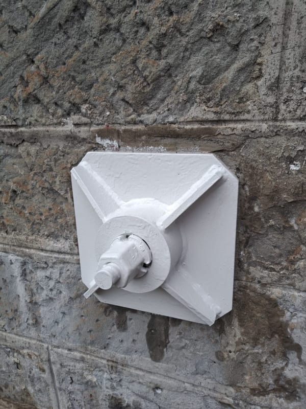

To you all, after OP permission, do think PT anchors should be utilized for such kind of old buildings ?
cost effective and fast remedies

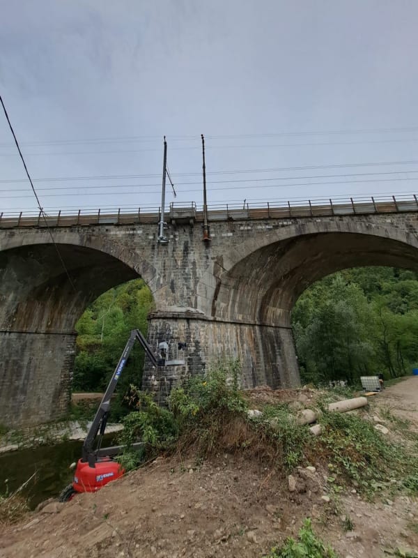

i have link for the Italian engineer who done multiple buildings like above "collapsed" one :
Link

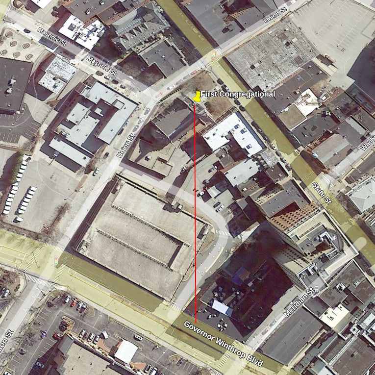

I think the video showing the collapse was taken from about here.
From that viewpoint, the steeple is falling to the left, which drops it on the roof.
You were pretty close. I believe it was taken from the car park access road (off Gov Winthrop Blvd) between the concrete car park and red brick building. The small penthouse structure for the stairwell, to the right of the steeple, gives a good identifier for more specific correlation of the images.
The car park seems to have an interesting history of structural deterioration, near collapse, and underspending on maintenance as well. It's possible that may have improved in recent years, but there are articles out there showing it being shored up with wonky pit props (since replaced with steel), unpermitted repair work, and talk of significant cracks and spalling; with derelict elevators. It also seems to have been purchased from the city in questionable circumstances, prior to it being allowed to deteriorate.

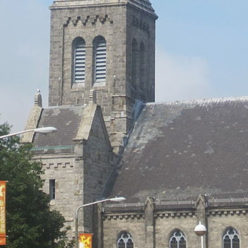

The video appears to show the steeple fall back onto the roof of the sanctuary, consistent with the debris. I would look for a loss of structural integrity along the north side of the steeple support, the line between the steeple structure and the sanctuary. Obviously an opening is required to move between the steeple structure and the sanctuary. Although there would be openings on all four sides the sanctuary opening could be on a grander scale and the roof line intersection above invites water ingress issues. As I noted earlier, interventions were already implemented to contain the steeple structure, and of note, along the north/south axis.
Would it be to much to expect that unnecessary loads such as bells were previously removed from the structure?

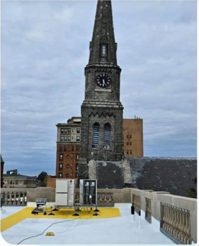

I'm a bit surprised that there was no indication of structural duress.
Photo of the steeple leaning back towards its roof long before the collapse.

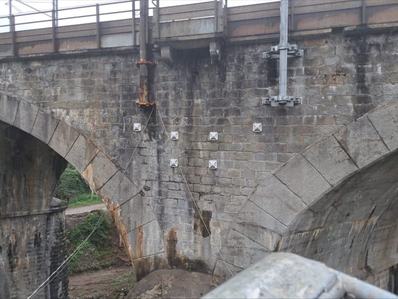

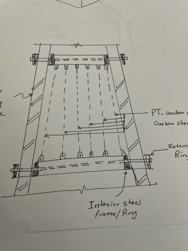

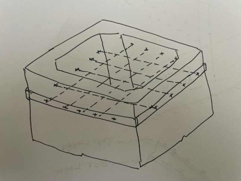

about the PT-retrofitting process, see attached

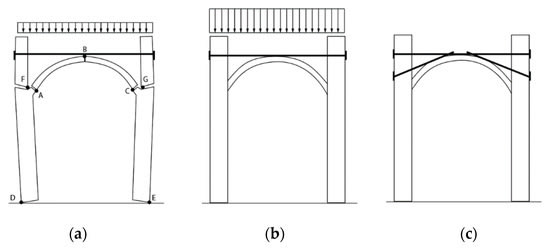

following paper confirms the proposed method
also done for historical buildings
Link
