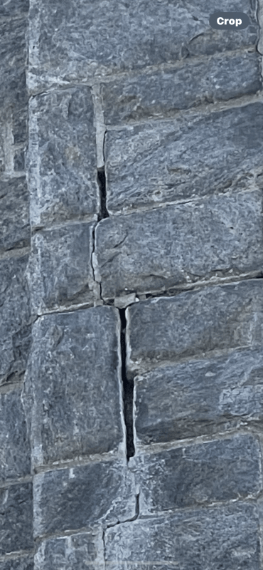

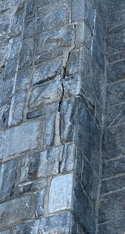

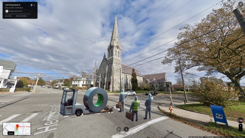

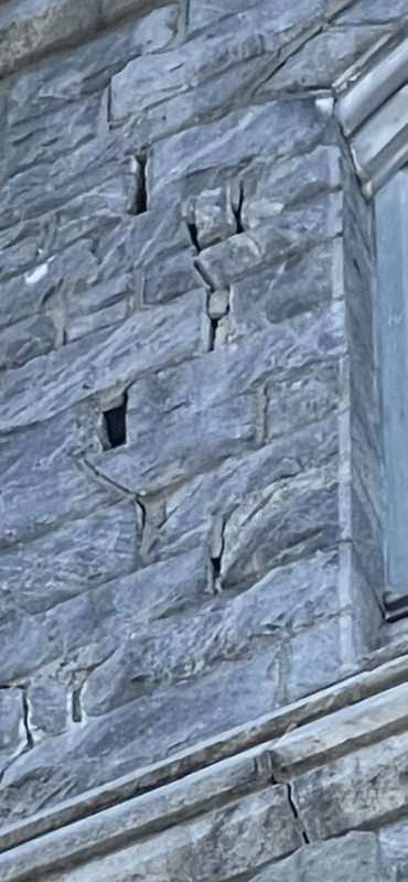

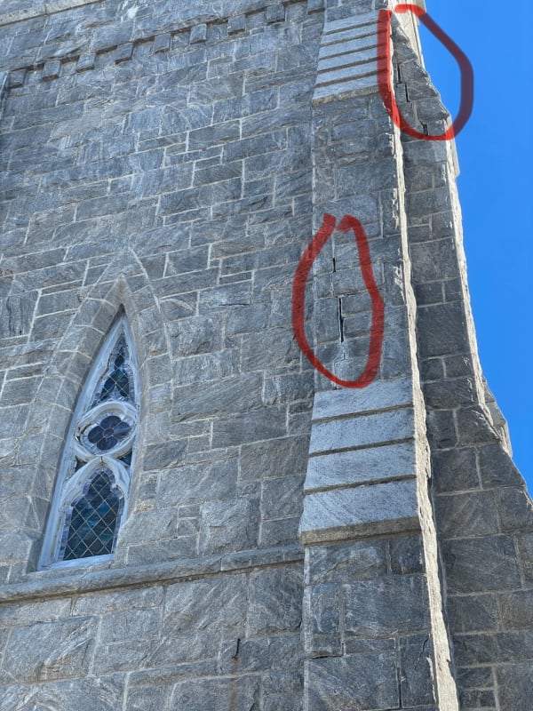

I took a few photos of a similar church in New London Ct and I was amazed at what I saw.
Dang that is incredible, and nice shots too by the way.
What church is this?

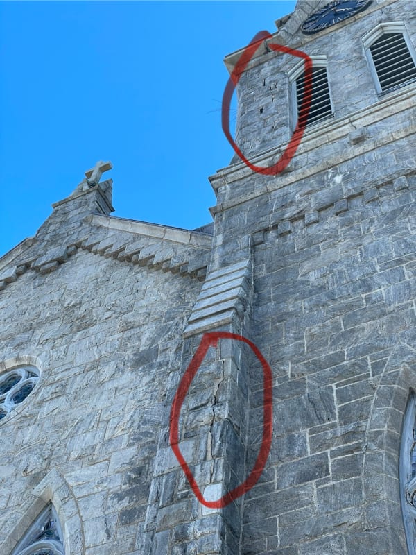

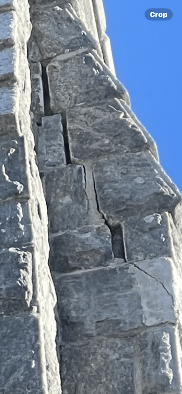

those cracks are so bad they look like weeping holes!
Time to get the shipping wrap to hold the loose stones together and make the cleanup more straightforward.
Time to notify the owners that they have a problem (public safety and welfare).
Suggest....strongly suggest, they hire an engineer to review if they haven't already, after pointing out the similar New London "adventure".

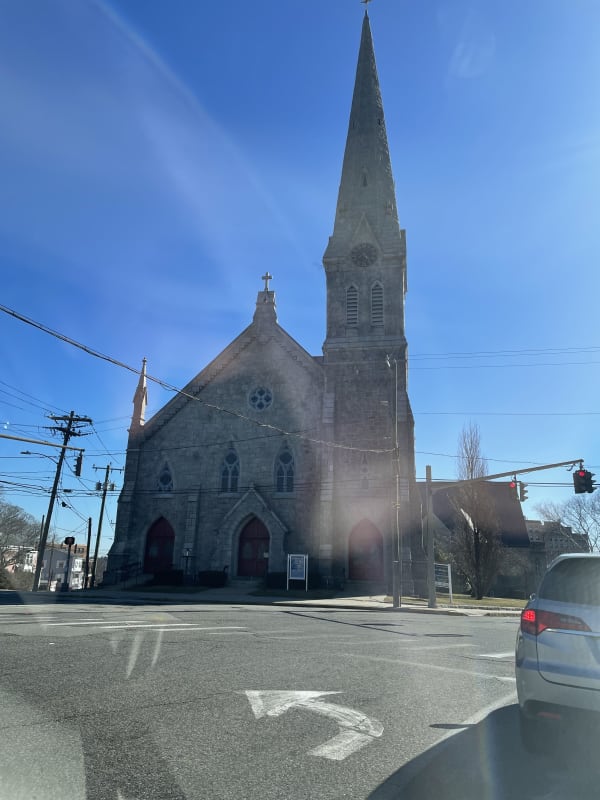

Looking at this view, it looks to me that there's a possible problem with the rainwater drainage in the last few years. The most recent image has a very dark/damp stain running down where the tower connects to the front of the church. There's not really enough images over time to be certain, but that's what it says to my non-expert eye.
