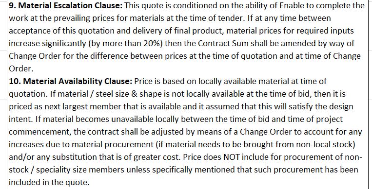

Not sure about consulting contracts since my consulting activities are pretty quick turnarounds. But my standard clauses for contracting are below. Note that I am usually a subtrade not a GC which is why I am a little more lenient with the stipulated amount of overage (20%). I've found that anything less is fighting territory; for some reason once you hit 20% everyone seems to go "ahhh that's reasonable". Not sure how that plays in the consulting world.
