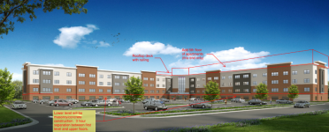

I am working on a proposal for new design for a 5 story apartment building. First story will be precast concrete with a 4 story wood structure above.
The building is proposed to be 153,000 square feet, about 34k sq ft on each floor. I've attached a few photos below. If I base the fee on approx construction costs, 1% of construction cost (assuming $200/sq ft) is $306,000. I think that is way too high. If I go at $0.50 per square foot for structural, I'm at about 75k. I asked a friend who does design and they said that 65k is a fair fee. It will be repetitive but I'm not really sure on this one. Wanted to see if anyone had any thoughts on this?
