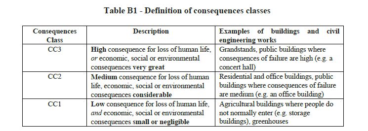

In calculating wind loads to BS EN 1991-1-4, there is an aspect which I a trying to reconcile with AS 1170.2 and AS 1170.2.
In AS 1170.2 there's an Annual probability of exceedance from Table 3.3. For a Design working life of 50 years with an Importance level of 2, the API is 1/500.
AS 1170.2 states: Annual probability of exceedance is the inverse of the so-called ‘return period’ better described as the average recurrence interval.
BS EN 1991-1-4 refers to annual probability of exceedence of 0.02, which is equivalent to a mean return period of 50 years.
Refers to BS EN 1990 4.1.2 (7)P which mentions "However in some cases the character of the action and/or the selected design situation makes another fractile and/or return period more appropriate".
Firstly need to check I'm comparing apples with apples.
Then I'm wondering why a return period of more than 50 years (say 250 years or 500 years) is not explicitly mentioned, rather than mention in 4.1.2 (7)P. Or does it it come out in the wash, as BS EN seems to use 10 minute wind speeds with an exposure factor.
The other thing I noticed was a consequence factor (kf) from BS EN 1990.
See attachment for reference.

Please look BS EN 1990 Annex ( informative ) B3 Reliability differentiation for consequences classes ,

I did see the sections for consequence classes. The equivalent in AS is an Importance level, for a 50 year design life, Annual Probability of exceedance is 1/500 and 1/1000 for an Importance Level of 2 and 3 respectively. Comparing the effect on the probability factor (c.prob) for 1/500 and 1/1000 events is less than 1.1, similar to the consequence factor in British Standard.

You are correct about the design life. It is essentially the same, 1/L = 0.02 (for 50 years) multiplied by the lifetime risk, r, to give the annual probability of exceedance. Refer to AS 1170.0 Table F2, Note 2, for the risk values based on Importance Level.
Thanks BJI.
Looked at Table F2 in AS 1170.0, annual probability of exceedance is r/L where r is the risk of exceedance equal to 0.1 for importance level of 2, so annual probability of exceedance for design life of 50 years is 1/500.
Perhaps I didn't fully understand British/European to begin with, but my inference now is that the risk of being exceeded of 0.02 or 1/50, for a 50 year design life, must be because it's a 10 minute mean wind velocity.
