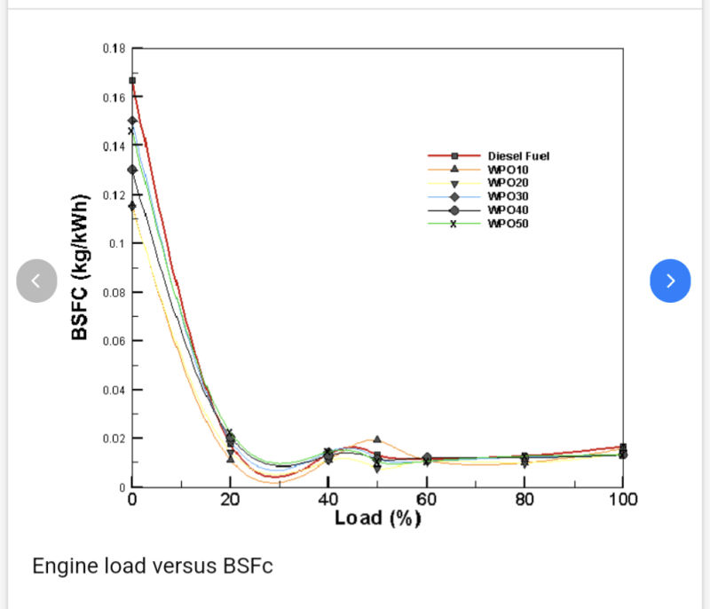

@TugboatEng. What is happening at 30% load on your chart where diesel BSFC drops to 50 g/kW.hr?
Whoops - just realised it is a trendline issue.
je suis charlie
The dangers of curve fitting! That's an overfitting error. In fact it's a dodgy graph, at 0% load by definition BSFC is infinite.
You get much better idea of the reason for the shape of that graph if you look at the curves of IMEP FMEP and PMEP vs load.
