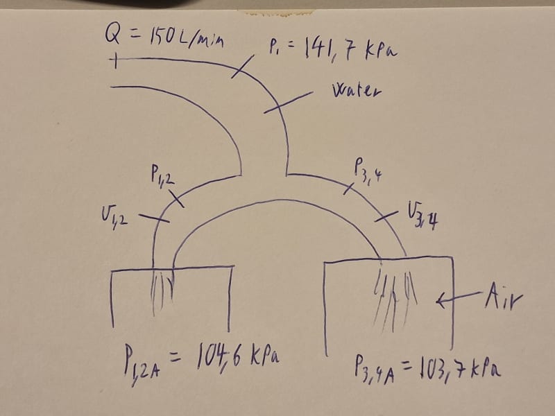

We are planning a process system. There will be a t-fitting after a water pump with a known flowrate.
After this, there will be a t-piece going to two different chambers with slightly different air pressure.
I have calculated the difference in flowrate on both ends after the t-piece using the following method:
The bernoulli equation is set up, with height=0 and removed from both sides. Pressure is different on both sides of the t-fitting, and this is known. Both velocities are unknown. I solve the equation and get something like 1,75=v1 + v2. Then i use Qtotal=Q1+Q2, and get another way of expressing v1 and v2. I then get two equations with two unknowns, and I can solve it. Ending up with a v1 is 20% greater than v2, which makes sense.
Anyone think this is wrong? I am unsure if it is actually correct to use bernoulli in this way....
Regards Carl from Norway

The solution starts with a sketch of the system. Since you need to draw one for yourself anyways, why not share it with us.
I have some sensitive IPR in my sketch, but I created another. What I am really wondering about is: During constant flow, will P1,2 and P3,4 be different?
I have taken the pump pressure 141,7 kPa and added the pressure above atmospheric from each chamber to P1,2 and P3,4.
P1,2= 144,6 kPa and P3,4= 143,72 kPa.
Put this into bernoulli, and got two unknowns in an equation (v1,2 and v3,4), and used Qtot=Q1,2 + Q3,4, and got another equation.
Solved this equation set, and got that v1,2= 1,95m/s and v3,4= 2,35m/s which may seem like a large difference due to the low pressure difference, but from our earlier experiments, it makes sense.
We are still slightly unsure if we have used the bernoulli equation correct here.

If the distances are as you sketch and the orientation, then any slight difference will have an impact.
So a small length difference or in this case orientation can make the difference. Try having both pressures the same if possible and then see if there is a difference in flow.
try moving the incoming pipe around to avoid swirl having an impact.
Exit losses will have an impact.
So yes V3,4 as shown will be higher as you have a marginally higher pressure drop available and ~10% sounds about right, but better than that will be very difficult to calculate and in practice will be different. So much will depend on actual water velocity and how the flow splits at that tee.

I could clarify a few things. The t-pipe and resulting pipes are symmetrical.

- It makes sense that the pressure inside the t-piece will be equal, but how can I calculate the flow in each tube when the external pressure is different? The flow will be higher in one tube. If not Bernoulli should be used, what equation can I use?
We need to optimize on cost, so if we can drop valves and accept a slight deviation in flow, that would be best. To calculate the accept criteria, it would be best to complete the flow calculation and see its impact.

You use pressure drop calculations, complete with entry / exit losses.
I'm not sure if the 141.7 kPa is at the centre point of the tee or somewhere else?
If it is then the difference between the two is 37 to 38, which isn't a lot.
However if the 141.7 is actually some distance from the tee then the first thing you need to do is figure out the pressure at the middle of the tee.
If this is much closer to the end pressure then the percent difference might become more relevant.

Bernoulli is only applicable along a single streamline. You can compare two separate streamlines (P1... = P1,2... and P1...= P3,4...) but you can't just add the total energies together, as the head losses will be different in each leg. If you do this out and include head losses it should boil down to a typical pressure drop calculation approach anyways, as others have suggested.
I actually disagree with the basis of why you cannot use the bernoulli equation in this way. After talking with one of our senior engineers. He told me my calculation is correct ecept from I have neglected friction losses, and viscous forces. Even though it gives a good estimate, and that is the objective of the calculation.
