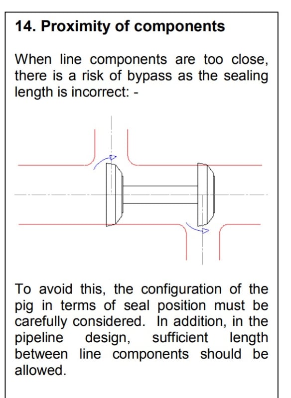

This sounds like a list of things that can make a pipeline difficult or impossible to pig. Rather than describing individual fittings these descriptions are of combinations of fittings or configurations that should be avoided in a piggable pipeline.
"unbarred full bore tee" is just a regular tee - a "barred tee" has bars in the branch so a pig wont nose into the branch and get stuck:
"tees with <3d straight pipe between" Putting two tees close together can cause a pig to get stuck:

tees with <3d straight pipe between - GBTs drawing is excellent to show why this is an issue
unbarred full bore tees - again GBTs picture is good. Pigs have an unnerving ability to do things you wouldn't have thought possible. It is quite easy for a full bore equal tee to get a pig going into the branch pipe and getting wedged there. I once saw a pig manage to reverse itself doing this ( a small bi di pig). I doubt there are many operators who would actually allow the pig run to happen if they thought there was a full bore equal tee without bars.
