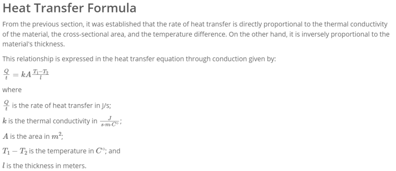

This equation is based off of your oil temp being constant, so as your oil temp (T2)changes your Q will decrease but it may work as a starting point depending on how accurate you need to be, but this should work. You can also do some calculus to account for the dynamic change.

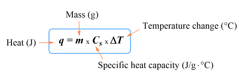

Then plug your answer into this:
Isolate your delta T for your final answer.
