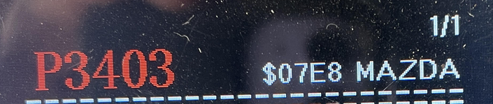

I have a 2023 Mazda3 6MT with a 4 cylinder 2.5 engine. It has cylinder deactivation where it runs on two cylinders under certain operating conditions. It does this by energizing an oil control solenoid which pushes a pin out of the hydraulic lash adjusters causing them to collapse instead of the rocker arms pushing down the valves.
On the highway, it is pretty unobtrusive and provides pretty impressive fuel economy. Around town though, it is annoying AF. Anything under 2k rpm, it vibrates when in CDA mode. As such, I always find myself driving one or two gears lower than I normally would to keep the RPMs above 2,200 where it smooths out nicely. I typically would like to drive at 1,500 RPM's as the engine has no problem doing this and the "suggested gear indicator" always wants me there for best fuel economy.
None of the aftermarket tuners are able to access this part of the ECU to turn it off. As such, I took matters into my own hands by simply disconnecting the CDA solenoid electrical connector. Sure, I have a constant check engine light, but the car seems to just use the non-CDA map. It is like a completely different car now. So much more enjoyable to drive. I am actually getting better fuel economy as I can drive in higher gears around town without the annoying vibration of 2 cylinder mode.
So other than CEL, i see no downsides to this. I suppose if there is an unrelated fault, I will not know as the CEL is already on. However, I feel like that would be pretty apparent in the driveability.
Y'all have anything for me?
This is what the tuner said:
Ok! This is a CEL code that I have access to in the ECU to disable.

Intercepting the harness connector won't accomplish the desired task (assuming the desired task is to disable cylinder de-activation without having a fault-warning lamp and underlying code). Even if it contains circuit trickery to fool the system into thinking the solenoid is still connected, the on-board diagnostics are still going to be able to detect that it didn't accomplish the cylinder de-activation. It will just flip from a "circuit open or shorted to ground" type fault code, to a "system performance" code.
I am aware of that, Brian.

Still have mine disconnected with no negative effects so far. Much more pleasurable to drive. Only have to disconnect one and it shuts the whole system down. I put a latex glove over the connector and plugged it partially back in to keep moisture out.
The gas mileage drops 1 or 2 on the highway but it is well worth it for me.
