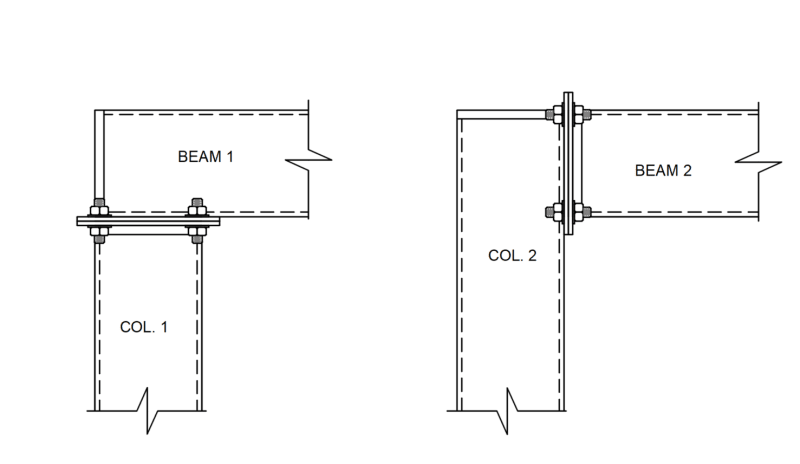

What is the preferred method here, run the HSS beam over the top of the column... or have the HSS beam attach to the inside face of the HSS vertical?
I can come up with the individual connection to resolve shear, moment, etc. Just taking a poll on the most accepted method.

I run it over the top so I can use cap plates with bolts, and have the framing above use clip angles into each other. If you connect it to the sides, you'll end up using knife plates, which is more cutting/welding and also a tiny bit of accidental eccentricity.

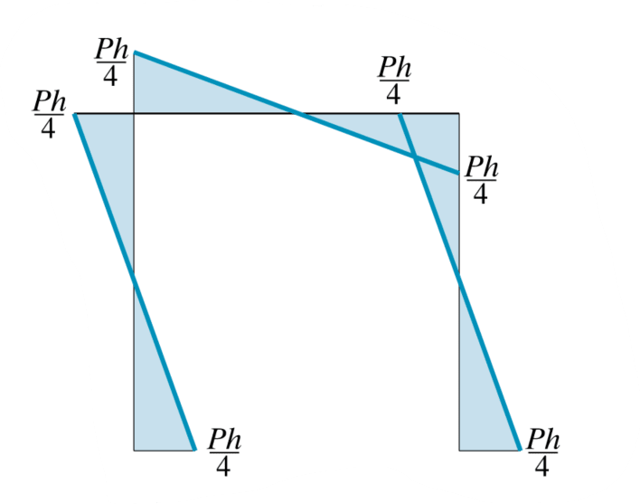

For the sake of the exercise, would either method here result in the same forces in the anchor bolts that hold this moment connection together?
The particular loading scenario I'm considering is for lateral load as shown below:

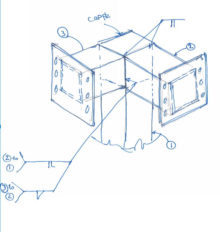

1. Not very big. They would be HSS6x6 tubes. Shop assembly is not possible. These frames components would need to be erected in field.
2.Yes, either bolted or welded connections are acceptable.
3. This is a new build. The the aesthetics is not a primary concern for the overall connection. However, a less bulky/cumbersome connection may be preferred.
4. In plan view, it will be a four sided moment frame. So each corner will have (2) beams at a 90° to one another.

StrEng007, a few follow up comments to your last post:
[ul]
[li]Just me being picky, but words matter - we're talking about bolts here not anchor bolts[/li]
[li]Bolt forces will not be the same. Depending on geometry, you might have similar reactions in the bolts due to the bending moment. But, I'm assuming there is other load transfer at this joint and axial/shear transfer will be very different in the (2) arrangements.[/li]
[li]If this is a (4) sided frame I can appreciate that shop assembly is not possible. What about shop assembling (2) of the sides and bolting the other sides on site? This would simplify the connections[/li]
[li]If aesthetics aren't a concern your best best is to provide bolted connections. They will be ugly (according to architects, I like the look of a big bolted connection).[/li]
[li]Neither of your (2) bolted options will work because you have HSS from both directions. The plates and bolts will foul each other. If you shop weld (2) of the sides I think the beam framing into the side of the column option is back in play.[/li]
[li]See below suggestion. Shop welded stubs are very helpful in this situation to get your bolts away from each other. You get the pre-coffee version of my sketch, apologies for the sloppiness. Keep in mind that when you use the shop welded stubs you're doubling your connections with a shop welded connection and bolted connection for each member end ($$). Use this sparingly.[/li]
[/ul]
jersey, Thanks for the advice. It looks like I will end up taking that direction due to architectural wraps on the beams and columns.
Canpro, All of your feedback is much appreciated. That's a pretty good pre-coffee detail.

@StrEng007: If talking anchor bolts, if we can assume the two connection methods provide the same stiffness and rigidity, then the forces in the anchor bolts should be the same. The forces in the connection bolts likely differ as the orientations and axis of loading is different, but the overall moment transfer (assuming same stiffness) should be the same and therefore anchor bolt loads the same. That is in practice, however if diving into the weeds I am inclined to think the second connection detail provides more connection stiffness since both the top and bottom flanges of the beam are restrained versus option one where the top flange is unrestrained. Therefore, the forces on the anchor bolts would vary between the two connections. I think this difference is so small it doesn't functionally matter, but this is my thought just for the sake of the discussion. I am looking at this from simple portal frame behaviour. Just my two cents mate.
