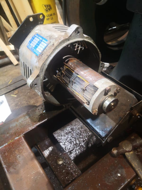

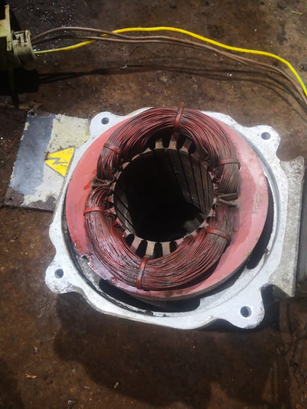

" I have a generator currently on 110v an works fine but I want 220v from it how do I do this I have 8 wires coming out .the gen is 110v-220v 3000rpm 50hz"

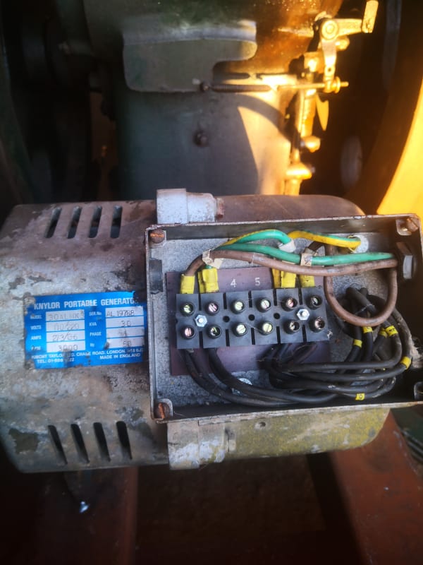

I have the following proposals for your consideration.
1. The label shows 110-220 V. It is designed to be reconnectable from the existing 110 V to 220 V. Unfortunately this information is not shown on the name-plate. See whether the information is shown on the reverse side of the terminal cover.
2. If above failed, send a mail to the motor manufacture request the connection for 220 V.
3. Some of our friends may have information and would be able to advise.
4. If all above failed, you may use a 110 to 220 V 50 Hz step-up transformer. In this case, the gen is running as it is, at 110 V 3000rpm 50Hz. The output from the step-up transformer would be 220 V 50 Hz.

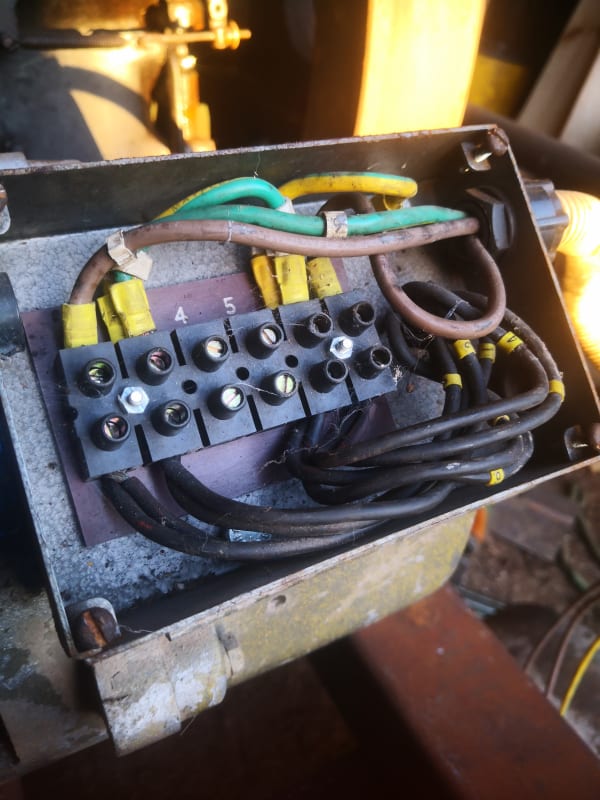

An educated guess with about a 97% probability.
That looks like a two winding machine, but eight leads suggests four windings.
HOWEVER, machines in that size may use two leads in parallel in place of single leads.
But we may be able to continue without knowing that.
It is not clear from the picture.
Is there a jumper from terminal 1 to terminal 6 or terminal 7.?
Is there a jumper from terminal 2 to terminal 6 or terminal 7.?
Can you confirm that there is 110 Volts between terminal 1 and terminal 2.?
Can you confirm that there is 110 Volts between terminal 6 and terminal 7.?

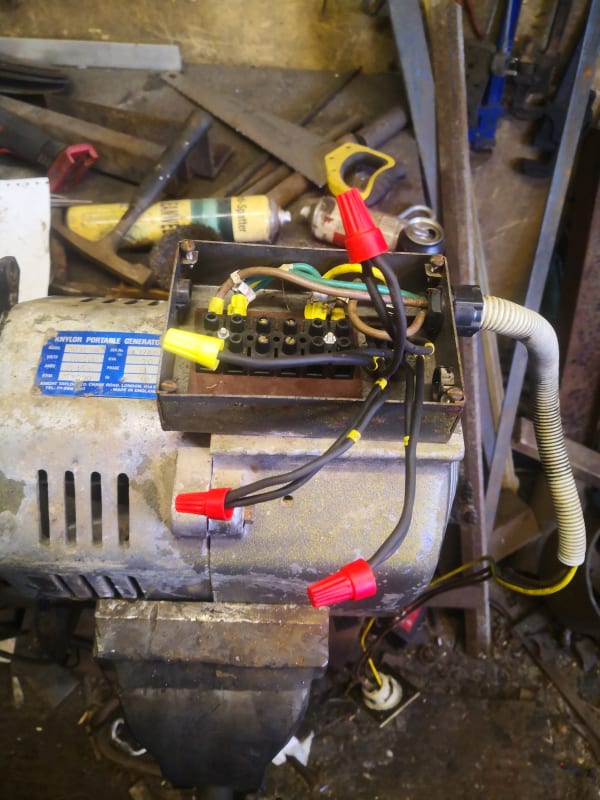

Davies... It looks like you have three leads (two browns and a green/yellow) from the generator to your "remote outlet" connector. What I can't see is whether the two browns are to different terminations or the same one at the outlet. My guess is you measure 110 from each brown to green/yellow.
The motor leads are in pairs (parallel) to handle the output current requirement. There are two each to terminals 1,2,6, and 7 within the generator terminal box. The brown external leads are connected to T1 and T7; the green/yellow connection runs from the generator to T6, which is then connected to T2, and from T2 out to the "remote outlet".
To double the output voltage, the coils have to cut twice as many flux lines in the same time period. That happens by either doubling the frequency (i.e. spin faster), doubling the available coils passing through the flux (i.e. more turns per coil OR more coils), or radically change the machine geometry (affect the flux distribution factor).

It's a dual voltage generator. You just need the correct external configuration for 110/220 V.

I suspect that there are two jumpers in the terminal box.
If so, removing one and reconnecting the other will give the desired 220 Volts.
But, no word from the OP.
Or, the generator may be wired for 220 Volts already and one connection needs to be moved.
But no word from the OP.

My
So the current confirmation is
8-4 hot )
)110v between the 2
1-5 hot )
Wire 2-6
3-7
Go to earth
I have paired the wires with continuity
1-2
3-4
5-6
7-8
So just wondering if I went daisy chained (+) 1-2-3-4-5-6-7-8 (-) that would be series ? Sorry I'm no electric engineer I know a little but no expert .
At this point the easiest solution is to take it to a shop.
They will be able to quickly and easily reconnect the generator for 220 Volts.
