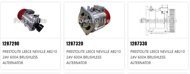

I may have found your solution;
Screenshot 2025-01-26 at 23-55-38 .pngCatalogue Page
24V nominal (over 27 Volts actual) @ 600 A = Over 15 KVA
Add that to your batteries and inverter and you should be good to go.
These have the advantage of being brushless. An advantage for marine applications.
Prestolite/Leece Neville
