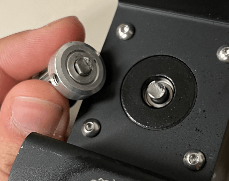

Hello,
I'm having trouble determining how to account for stress concentrations at the root of the flat on a motor shaft due to overhung radial loading. I inherited a motor/pulley assembly that has an propensity for the shaft to snap off right at where it transitions from a D-shape to circular cross section. The pulley pictured below has a belt on it that applies the loading.
There is not a fillet where the shaft changes profile
I've looked through most of the resources I have here and I can't seem to find anything that addresses this particular situation. It' probably because it's not a great design...
So, I was just wondering how to properly calculate the fatigue life or at least how to account for the huge stress concentrations at that transition point due to bending.

If it is sharp enough corner it's likely to be 10X to 100X the nominal stress for a shaft that diameter. Most applications avoid the situation rather than accounting for it. You may be able to determine how many cycles the shaft is getting based on time in service and utilization.
If you have to use that motor, rework the shaft to smooth the transition.
Flipping the pulley to reduce the overhang and being sure the belt is not over- tensioned can help too.
If the belt pull from transmitted torque looks to be a problem, increasing both pulley sizes to maintain the ratio reduces the working belt tension
Like others said, a sharp corner by itself is a big problem.
Got pictures of some failed shafts?
Stuff like the fracture initiation point, the fracture surfaces, setscrew bitemarks, and fretting from pulley micromotions can be valuable forensic clues.
Who is the motor manufacturer - does their literature list allowable overhung load? That shaft may be intended for direct-coupled use where the shaft slips into a quill on a reducer, thus transmitting only a torsional moment, no bending moment. Even if you reduce the load enough to stop breaking shafts, you may still be overloading the shaft bearing and just move down the line of failure points. You really need to stick with rated loads.
Thinking out loud here. Crankshafts on engines often have undercut fillets. Perhaps you could use a small file to undercut the sharp edge a bit. The loss in cross section area may be offset by the reduction in stress concentration. I don't know if this thought is true, the undercut fillets on crankshafts are rolled, not cut, so they contributed to the strength and reduce stress concentration.

Here's a picture of the shaft, it's right at the transition point:

@desertfox Thank you for the response! I did find that the overhung load was over mfg specs and have already implemented a better tensioning procedure. Unfortunately, some failed units were below the overhung load spec and there are also a lot of these in the field already. I inherited this issue/design so it's been a bit of detective work to figure out exactly what assumptions were made. Here's a picture if you want to see more closely.

Thanks for the response and photographs and it certainly looks like a fatigue failure, have a look at this site giving photos of failed shaft and their causes.
I appreciate that the shaft isn’t completely round and that there will be a stress concentration where the flat is, however if you ignore the flat on the shaft for the sake of a calculation and assume that shaft is completely round you can then calculate the maximum principle stresses using the mohr circle. The shaft is failing under fatigue however the maximum principle tensile stress causing the failure is a combination of the overhung load and the motor torsion and not one or the other.
Google mohr stress circle for shafts under torsion and bending loads.
I have a suggestion for a fix:
I can see the inner race of the motor bearing in your picture. Manufacture a spacer that slides over the shaft and rear against the bearing inner race.
The spacer should be long enough to extend beyond the step transition between D and round sections. A few thousand of an inch should be sufficient without negatively impacting belt alignment.
Butt the pulley firmly against the spacer prior to tightening the set screw.
Ideally, some of the bending forces will be transfered by the spacer so less will be seen by the shaft.
Your success will depend greatly on how firmly you can butt the two together. Perhaps a Belleville spring arrangement will make assembly more forgiving?
