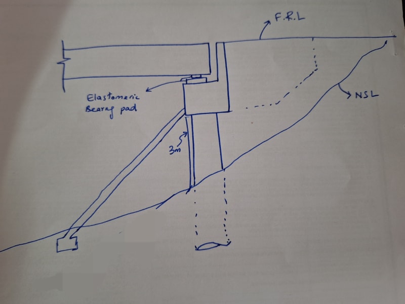

Hi! We are designing a single span bridge comprising spill-through abutments at the ends instead of retaining wall abutments. The abutments are initially planned as pile bent piers with height (till depth of fixity from NGL) approximately 15m. The piers will protrude from the fill for 3m till the pier cap.
AASHTO LRFD suggests no seismic design be carried out for single span bridges but I think this one should be analysed and designed for seismic forces. My reason for this is that unlike abutment retaining walls the spill-through abutments might be able to move separately from the ground (due to insufficient restraint provided by the retained fill to the piers) and will require seismic analysis and design to be carried out. Am I right with my concerns? Please guide.

A sketch of the proposed configuration is needed for us to understand how seismic displacements might affect the connection.
That said, if it's going to be on 15m piles, the typical abutment type would be fully integral. We wouldn't even consider a different substructure type for a single span bridge on piles.
Thanks for the replies. I see my post didn't portray the situation properly, so I've attached a handmade sketch of the proposed configuration.

-You have correctly understood the situation you mentioned in your last paragraph. A backwall is provided behind the girders (RC/Post tensioned) and it isn't an integral abutment. For now, we're not considering providing integral abutments here.

Hassaan - what's the purpose of the diagonal brace, is that permanent? Your piles look to be robust; they should be able to take up the lateral load.
I was wondering about the diagonal brace also. If this bridge is over a creek, the diagonal brace would need to be embedded adequately below the scour elevation. We've sometimes done 2 rows of H-piles with the front row battered sort of like that, except only on a 4 to 1 (vertical to horizontal).
My apologies for the confusion. As I mentioned, this is a spill through abutment. The diagonal "element" as it seems in the sketch is actually just stone pitching for slope protection of the retained fill. I forgot to mention this in the sketch.
I'm still not clear on where the proposed ground surface is and where or if there's something acting as a retaining wall.
I think if your pile spacing is 3B or less, for longitudinal loading, you effectively have an abutment wall.
