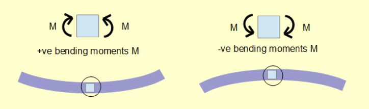

Other than the sign of his moment diagram, using international convention, his moment and shear diagrams are correct. Moment and shear diagrams are often drawn opposite to what international convention requires. The reaction on the LHS is down. This is a neg force on a neg face, ie +ve. As you move away from the support the moment increases linearly. The moment is positive (via RH rule). The resisting moment has to be -ve, else it accelerates, which is what the BMD shows... [pipe]

A simple beam supporting gravity load has tension on the bottom and compression on the top. I consider that to be positive moment. For length 'a', this beam has compression on the bottom and tension on top, which I consider negative moment. The short section 'b' has positive moment.
If there is some international convention which says otherwise, I am not aware of it. Common practice is as I have indicated above.

I am not sure where you found this convention, dik, but it is not intuitive. The sketch below indicates positive shear on the left end and negative shear on the right side of a beam loaded with gravity load F. When the reaction at A is upward, shear is positive, but in our case, the left reaction is downward, so shear is negative all the way across the beam.
Bending moment at any point 'x' in the span is the integral of the SF Diagram over length 'x', so it makes sense to call the shear negative for consistency, because we choose to call the moment negative for length 'a'.
Perhaps it's not worth debating, because if we view the beam from the opposite side, the sign of the shear is reversed. As Luceid suggested, if you know what you're doing, use whatever convention you like.

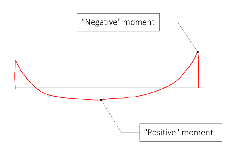

I think that people working in concrete would typically flip the "sign" of the moment diagram from your image above BA, as a tendency to get the moment diagram on the tension side - thus the diagram shows you which side of the beam the rebar is on. This isn't explicitly correct with the mathematical integration and whatnot - but practicality overrules for designers. I think almost all of the time I have seen concrete moment diagrams that look like this, where folks call the moment of the line "negative" and below the line "positive."
Again, whatever works for us!
I've seen that too, and normally there is no difficulty understanding what is meant. In the case at hand, a negative sign was used on both the SFD and BMD. But maybe it's time to put the question to rest.
