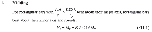

This is a simple AISC 360-10 F11 Rectangular bar yielding check.

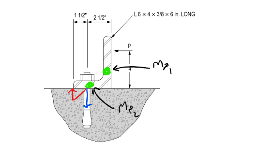

The tension force would likely be a little more than 2.67 x P. For flexure, I'd use the plastic section modulus for the angle leg thickness... I wouldn't have even bothered to calculate Sx. You can work out whatever load factors or safety factors, accordingly.
Your calculation assumes the critical bending plane is in the vertical leg. There are two bending planes one in the horizontal leg due to prying action and also the one you have chosen for equiv. cantilever action of the vertical leg. Since the thickness and material are constant the critical bend plane is in the horizontal leg.
Either Mp1 or Mp2 are sufficient on their own to create a mechanism and both are only influenced by P such that Mp2 will be the critical hinge.
If instead the loading was reversed then the compression block would sit in the heel of the angle and reaction formed there would influence the horizonal leg hinge points. Since Mp1 again is sufficient on it's own to create a mechanism and only influenced by P that becomes the critical hinge.

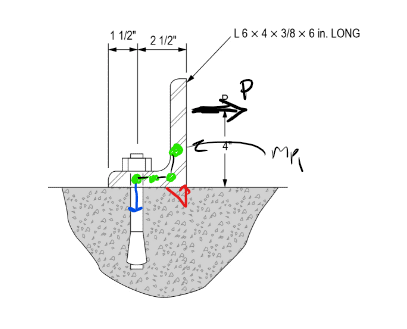

Celt's sketches above are correct. The horizontal leg (Mp2) controls, hence the larger moment arm.

Yes, looking at this again, the horizontal leg experiences a larger moment and since it has the same cross-section, will control in regard to bending. Not sure why I missed that...

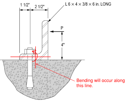

If the bolt is assumed to be sufficient, then I think the "official" solution takes the assumption that the bending will occur on the edge of the nut, and not along the center line of the bolt hole.
2023-11-12_16_43_14-PE_Civil__Strucutral_Practice_Exam__Solutions__-_Bluebeam_Revu_x64_gz7edd.png

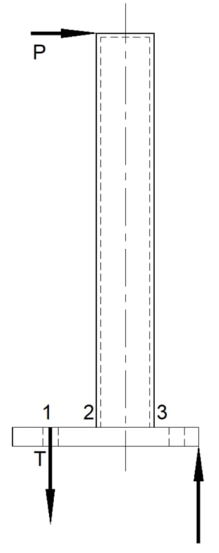

For guardrails, I check the hole location, the face of the post where the fastener is in tension and the face of the post where the edge of the base is in compression. The gross section is used at the post. I use prying action to determine the load from the fastener, as it affects the base design. It has no effect on the design of the post to the base, but can have an impact on the fastener design as well as the base design.
I'm not sure I understood this, could you explain this with some sketches?
