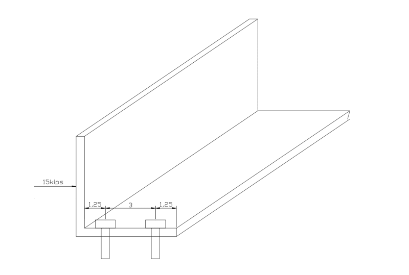

I needed to evaluated the capacity of an angle with a concentrated load.
Bolts are in pairs each 12 inches and load can be either aligned with bolts, between bolts or any other position, but always in the same direction and high (3")
The proposed angle is L6x6x1/2, but I have modeled it as areas in SAP2000 and stresses are higher than Fy/1.67 for bending.
Is the thickness not enough? How can I evaluate it better?

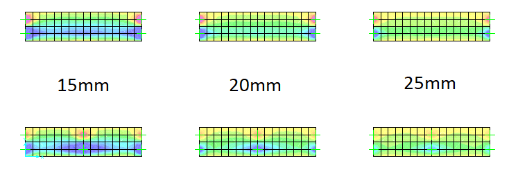

Look these images, I have limited stresses to Fy/1.67
1/ first is the loaded side of the angle, the local effect are clear.
2/ second is the anchored side of the angle, the bending overstresses is clear too.

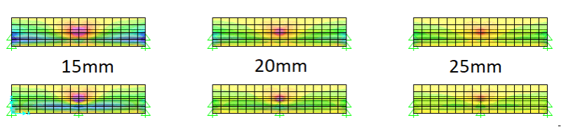

3/ Up are with the load bearing between anchored points, down are with the load bearing directly on bolts.
I have tried with 20mm and 25mm of thickness instead of 15mm and the stresses looks controlled.
But it's that "looks good" that doesn't convince me, I would like something more technical.

[li]The fastener at the free edge is the one that's doing the work; the one near the heel is collecting dust. The close spacing of the fasteners compromises the connection capacity. The only reason for two fasteners is for high shear, and I've not encountered a connection of such ilk.[/li]
[li]The fastener should be attached as close as possible to the free edge to increase the moment arm.[/li]
[li]For strength of the angle, use the plastic section modulus, not the elastic one... you gain 50% in strength (using LRFD).[/li]
[/ul]

the FEM pictures are showing the stress in the web ? the "punching" shear ? I think this is a problem (in FEM) of a point load. If you applied the load over a small area it'd probably disappear.
If you're looking for a technical approach to the applied width of bending, look into yield line solutions.

Thousands of these type of angle clips for aircraft have been analyzed by hand using a 45 degree angle assumption from the load point to determine the effective width at the base if the angle. Then check bending at the base of the angle, fastener tension, and pull thru of the fastener in tension.
There is no reason to bludgeon this with a FEM and get a bunch of confusing stress fields.

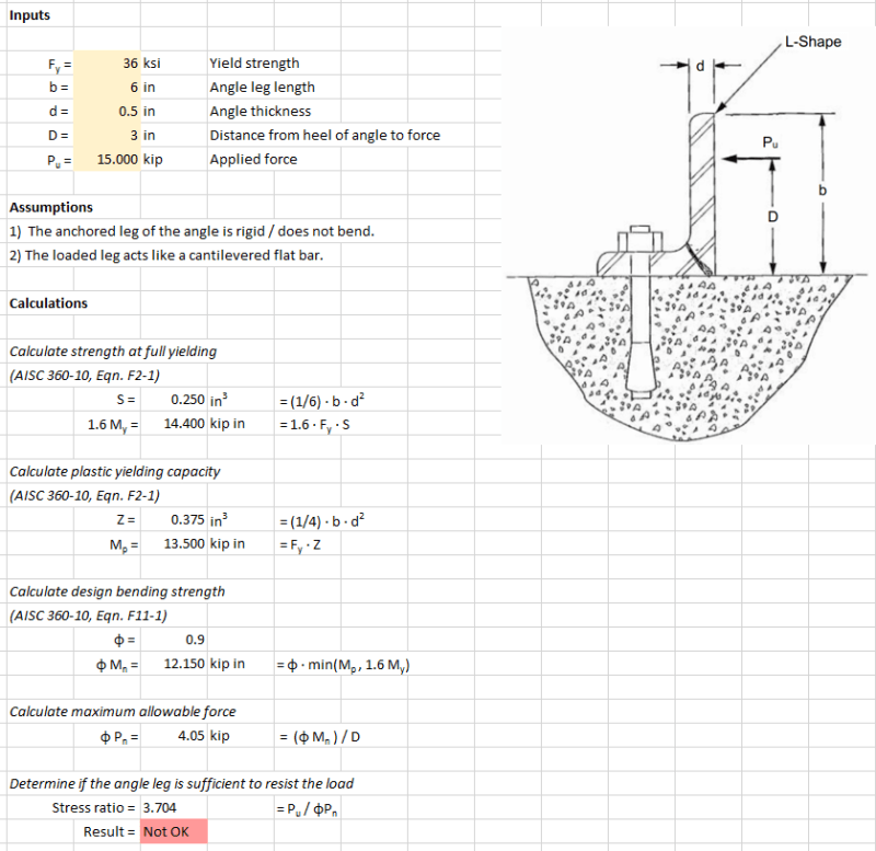

I forgot I made a spreadsheet based on the problem from the link I posted above. 15 kips on the leg of an angle is a really tall order, and I don't think it'll work.
Regarding the point you made about the angle in that problem being 15" long - I don't think you scrolled down far enough in that thread.

CrabbyT can you please share the spreadsheet to not re-calculate.

There are two bolts each 12 inches.
OK, what are the two bolts attached to? Is there air in the 12 inches between bolts or solid material, if solid material is the angle leg tight to this material?
Your FEM model is resisting your applied load via tension and compression in the bolts, if there is concrete backup material and the angle leg rests on this concrete then the compression will be resisted by leg bearing not by a lone anchor (especially since as shown in your original post there is no mechanism to transfer this compression into the bolt).
Yes, that is true, the angle is bearing on a 12mm steel plate, so the bearing leg will transfer compression to the plate.

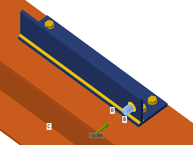

I have used IDEA to try to model the angle and it passes the check with the 15mm thickness.
I think IDEA uses the 5% strain limits so it assumed no problem with part of the angle yielding.
What do you think of this approach?
Should the b for the section modulus not be the width (into the page) of the angle? Is section modulus not calculated based on the cross section of the shape in question (rectangular leg of the angle)?
Yes, b is the effective width. How much would you take in B if the angle is continuous and the bolts are 12" O.C.
