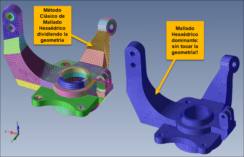

Tetrahedral elements can fit better any complex geometry, true, this is the strong point of TET meshing. But when you integrate the shape functions with Gauss points is less accurate than hexahedral elements. So the main limitation of HEX elements is the geometry.

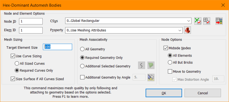

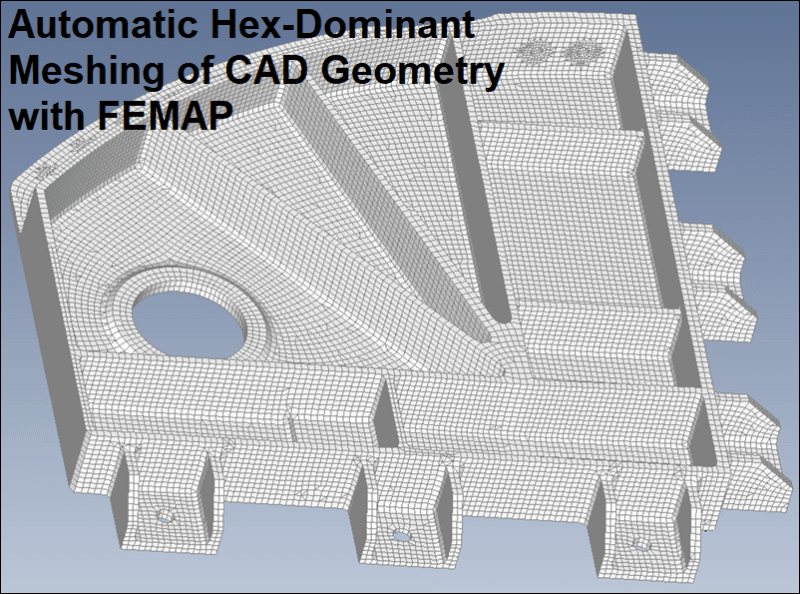

BUT we have in FEMAP V2306 a new command named "HexMesh Bodies" that is able to mesh ANY CAD 3-D solid geometry, with little to no simplification or subdivision into smaller and simpler regions, as long desired by the finite element analysis community. Simcenter Femap has collaborated with other development organizations in the Siemens Simcenter Portfolio in order to offer this exciting technology to Femap users (the technology comes from the guys of FloEFD for SOLID EDGE CFD code), I love it & use a lot!!.
The hex-dominant mesher first fills a solid volume with as many hexahedral elements as possible, then fills the remainder of the volume with wedge, pyramid, and tetrahedral elements, as needed. This process creates high quality elements which can be sent directly to the Simcenter Nastran solver with no additional interaction from the user or manual refinement of the mesh.
