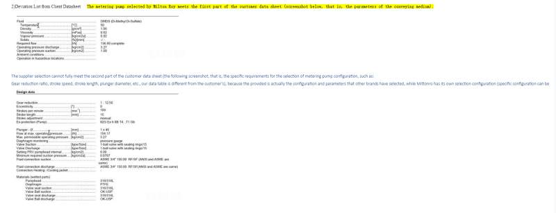

Dear All,
I would like to share a sample datasheet that has been presented. After reviewing it, I would greatly appreciate your input and thoughts on this proposal.
Thank you for your collaboration.

Dear All friend
It is evident that the manufacturer has submitted a proposal that deviates from the specifications outlined in the customer's datasheet. This marks the manufacturer's final response on this matter. Appreciation is extended for the prior responses in this context, and we invite further insights or opinions.
[tt][/tt]
Sorry but I can't read that, even opening in another tab.
But can you describe what you think is wrong with it?
It says manual stroke adjustment.
but if you don't like it for some reason then don't buy it.
Frequently, customer data sheets specify things that are physically impossible, so it's not unusual for a manufacturer to not meet the specification.
Looking at the blurry image, the customer requirements were for a competitor's solution which Milton Roy doesn't duplicate, such as gear reduction ratio, plunger diameter, et al.
I agree, nothing strange there.
They say they can meet the process requirements, but the specific parameters will clearly vary between different vendors.
So as long as they will guarantee performance with your specified fluid, the fact that you might have specified e.g. a different stroke length and piston size is neither hear nor there. IMHO.
I really don't know what your issue / problem is exactly?
