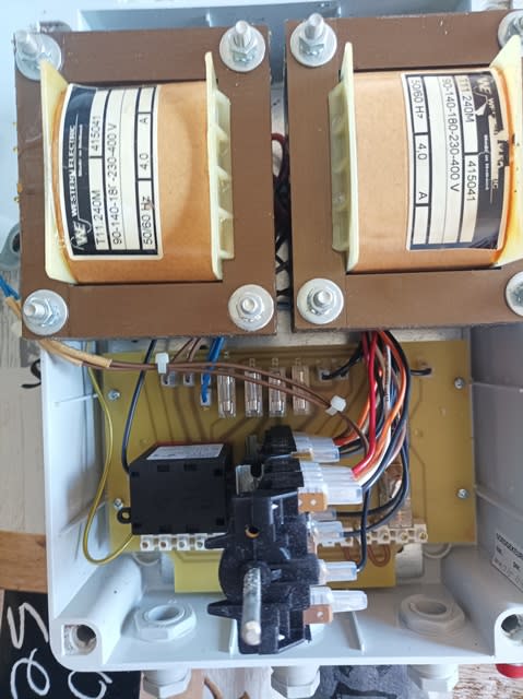

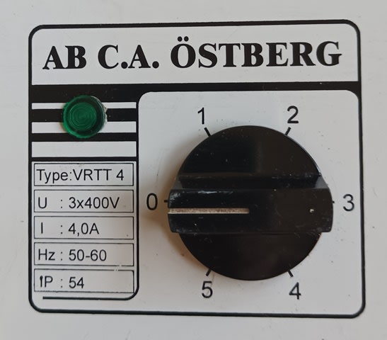

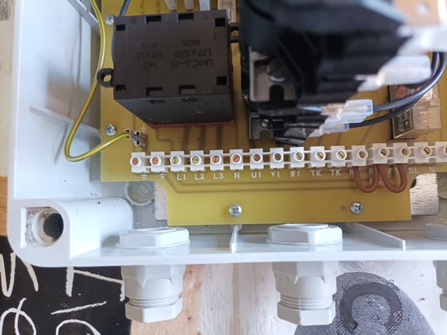

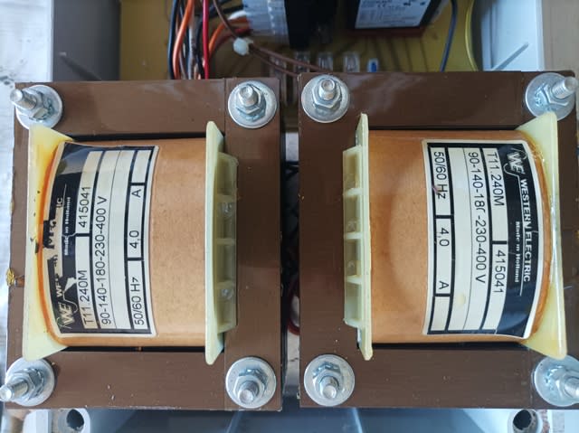

Attached are a few shots from a nearby service center that show a five-step speed control transformer regulator for the fan.
The speed is controlled solely by selecting the output voltage.
Such a regulator can be applied during the fan's startup, for example, starting at 230 V and then reaching the full voltage of 400 V.
This example is a manual regulator, although an automatic version is also possible.
What's interesting is that the speed of the three-phase fan can be altered using two (not three) transformers. These transformers are likely of the autotransformer type.
The main advantage of this method, as opposed to a soft starter and VFD, is that the motor receives a pure sinusoidal voltage.
Respectfully I would class that device as a speed control rather than a reduced current starter.
The only reason for reduced current start in a tiny 3 kW motor is if it is driving an extremely high inertia load such as a centrifuge.
And given such a theoretical high inertia load, the motor would likely not survive long the jump from 50% voltage to full voltage.
I agree with jraef, just start this tiny motor DOL and get on with life.
